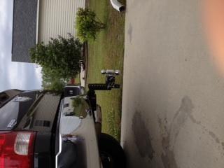

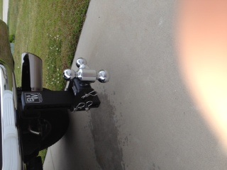

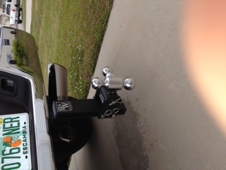

Here are some pics of my new B&W Tow and Stow 9.5" adjustable hitch. I originally ordered the 5.5" adjustable but it was still WAY TO HIGH even at its lowest setting.
WITH THE 5.5" drop, at the hitches lowest level, the top of the ball was exactly 22.5" off the ground. That caused both an enclosed motorcycle trailer, utility trailer, and 21' Travel Trailer to ride upward on the hitch.
WITH THE 9.5" drop, with 3 additional adjustments left downward, the top of the ball measured 20" exactly from the ground. RIDE HEIGHT PROBLEM solved. I can still go down 3" if I want to.
FYI, With my set-up and the ball all the way at the lowest setting, the bottom ball is still 9.5" off the ground. Unless you plan on taking the rear axle out, this thing will not scrub the roadway. OFFROAD, this thing might get in the way. Here are some pics.
