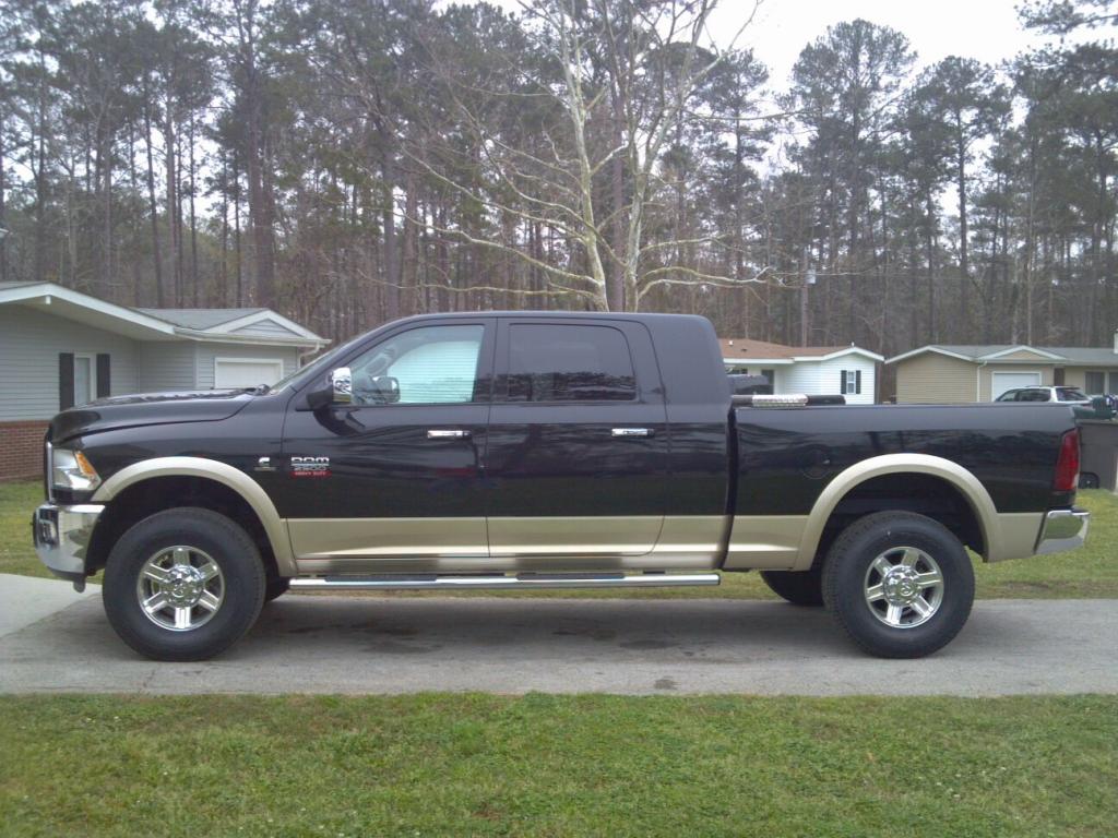

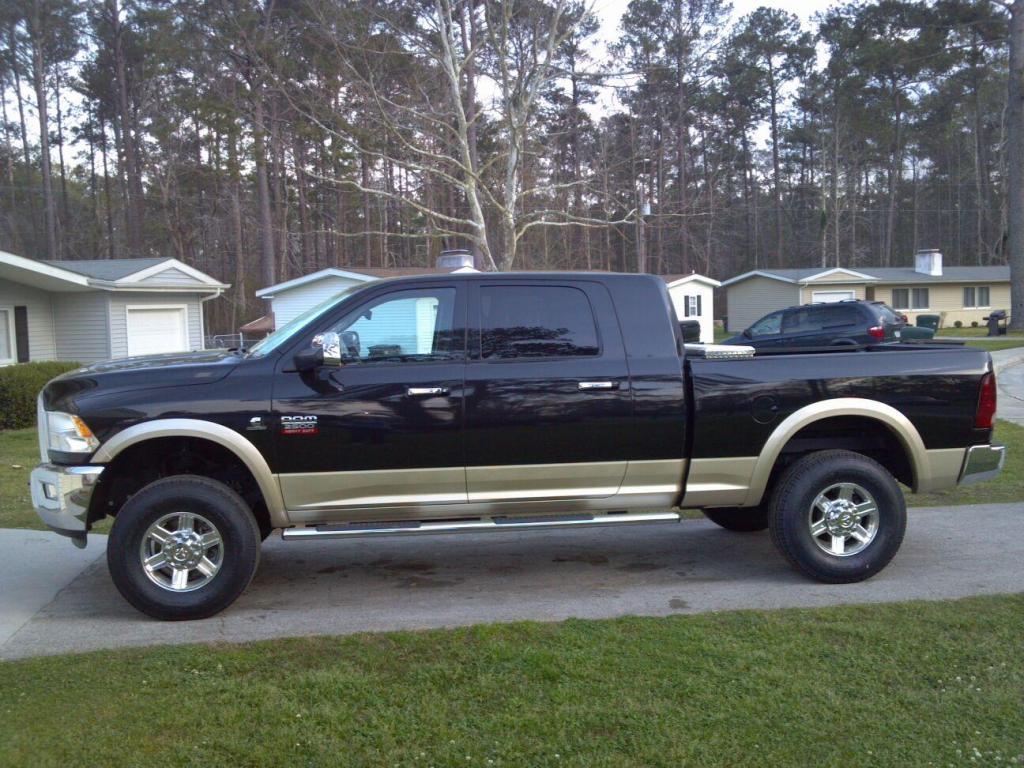

Here are the photos of my truck with the Nitto Dura Grappler in stock form, and then with the Hell Bent Steel 2 1/2" Leveling Kit, Bilstein 5100's. I am installing a 1" Top Guns Customz lift block in the rear after seeing the truck. That will make it 100% level.
What do you all think?

Looking good. I love everything about that truck except for the color. That has got to be the worst color combo Ive ever seen.....
Id leave it sitting just as it does. Looks perfect.

You know, looking at those pics again, I think that level kit made your truck even shinier!
That thing is awesome!

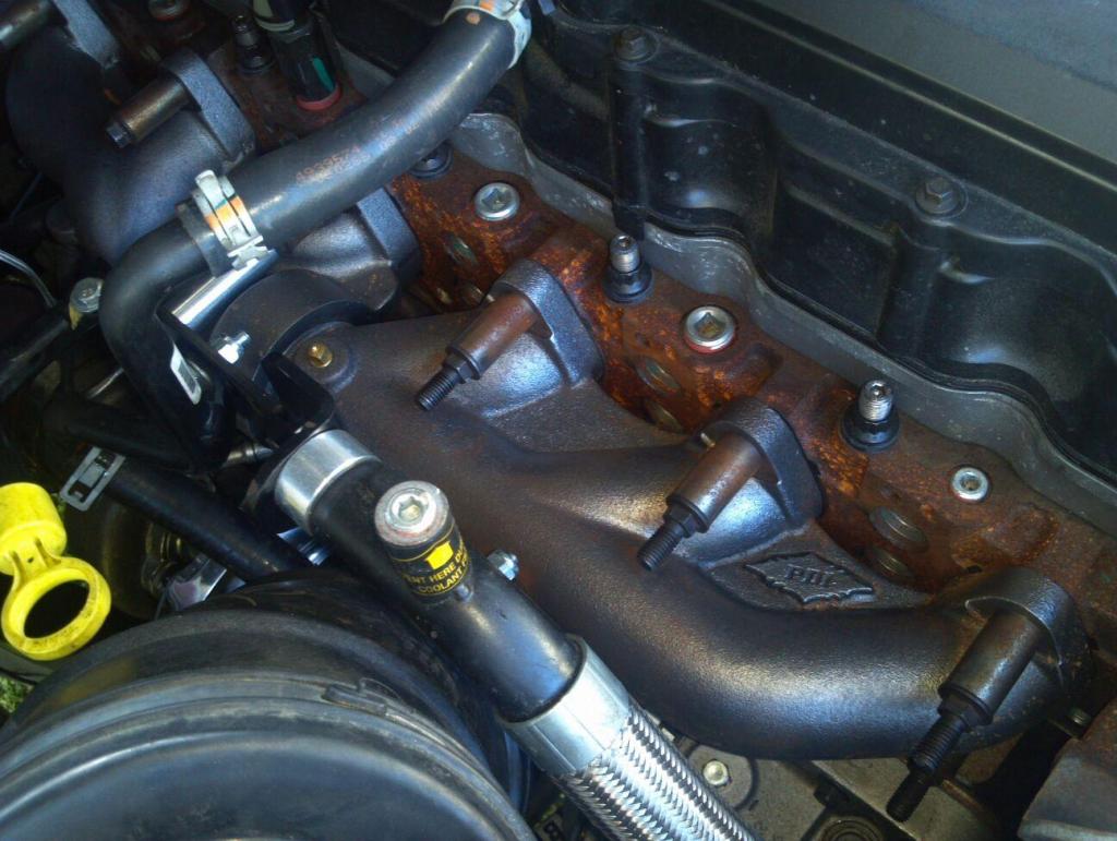

UPDATE: Well I have good and bad things to say after recieving my Industrial Injection Turbo and manifold. I ordered it directly from II and was guaranteed that there would be step by step installation instructions with the system. GUESS WHAT, NO install instructions. I wish I remember the guys name who I spoke with but I will definately be calling them on Monday.
Anyway, after looking at the install and observing the factory set-up I noticed some things and have some questions.
The PDI Manifold has a pre-tapped hole for what looks to be for an EGT probe but its on cylinder 3. The Factory set-up has some plug w/connector coming from the factory wiring harness into the factory manifold. What is that? Do I need to tap a new hole for an EGT probe on cylinder 5 or 6 and just plug the one on cylinder 3 that the PDI manifold has already?? Also, the IISS66 came with 4 studs and nuts which I thought were for mounting the turbo but the actual manifold came with 2 studs and nut. I AM CONFUSED. I do not know which studs/nuts to use in order to mount the new turbo to the new manifold. I also do not know what to do with the manifold or how to route the EGT probe. The PDI 2-piece manifold has cylinders 1-2-3 completely seperate from cylinders 4-5-6. They come together where the turbo mounts onto it.

The complete installation of my PDI manifold and II SS66 is complete. RESULTS: It has 100% eleviated all EGT issues associated with this vehicle. I currently have the wastegate set at 45PSI and with running the H&S Aggressive Turbo Tuning on "HOT" (Which is the highest setting) I saw a peak WOT EGT of 1200 degrees. That is 1200 degrees from a Pyro installed between the 5th & 6th cylinders. In Short, this is a guaranteed way to fix EGT issues but I do not recommend this install unless you have studs.
PROBLEMS DURING INSTALL: You will definately have to find bolts/studs to mount the manifold to the turbo. II did not send me any appropriate mounting hardward for this install. All parts I got from Lowes and all items were Grade 8 hardware. Fitting the factory airbox back on was an absolute nightmare. If you cut 2" off the factory tubing then you will have no issues. I WILL POST PICS LATER!!!

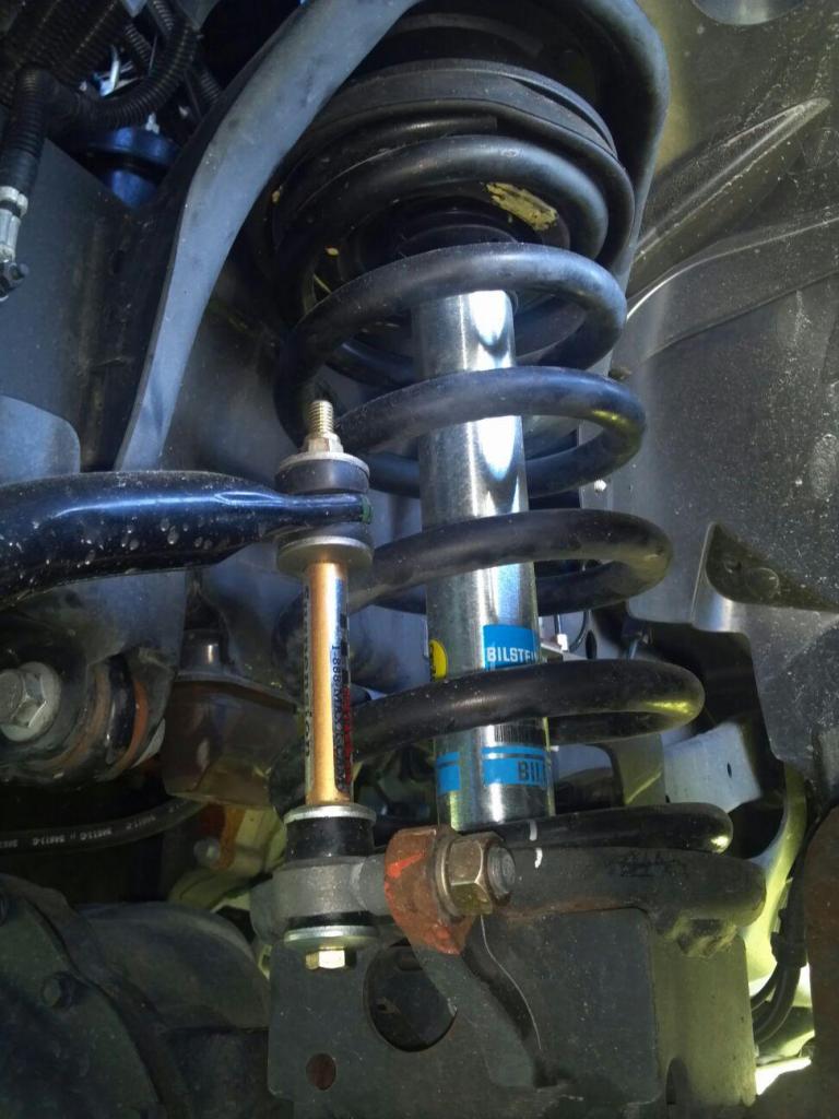

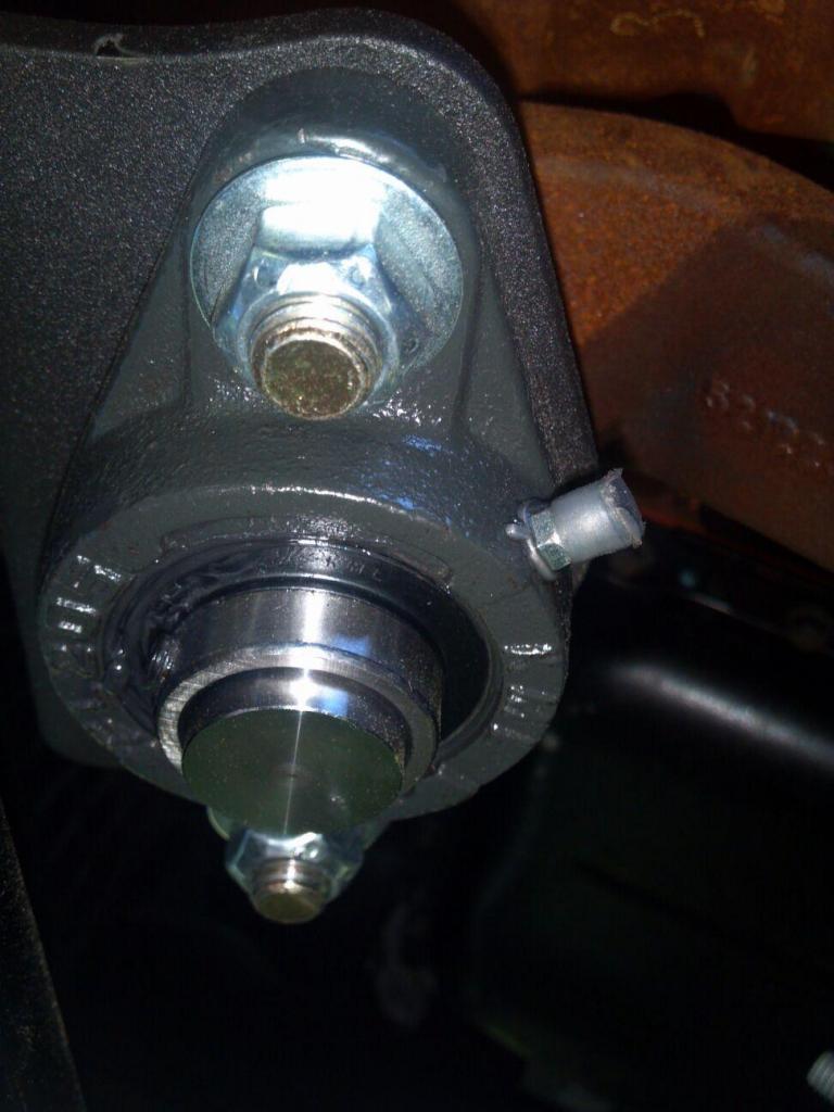

Here are the photo's of the Hell Bent Steel 2" Leveling Kit with the Sway Bar Drop Brackets, Steering Stabalizer, and Bilstein 5100's.
Kit fits 100% flawlessly in every way!!!

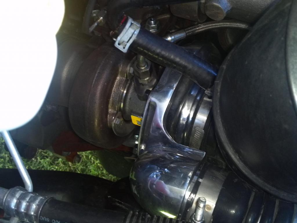

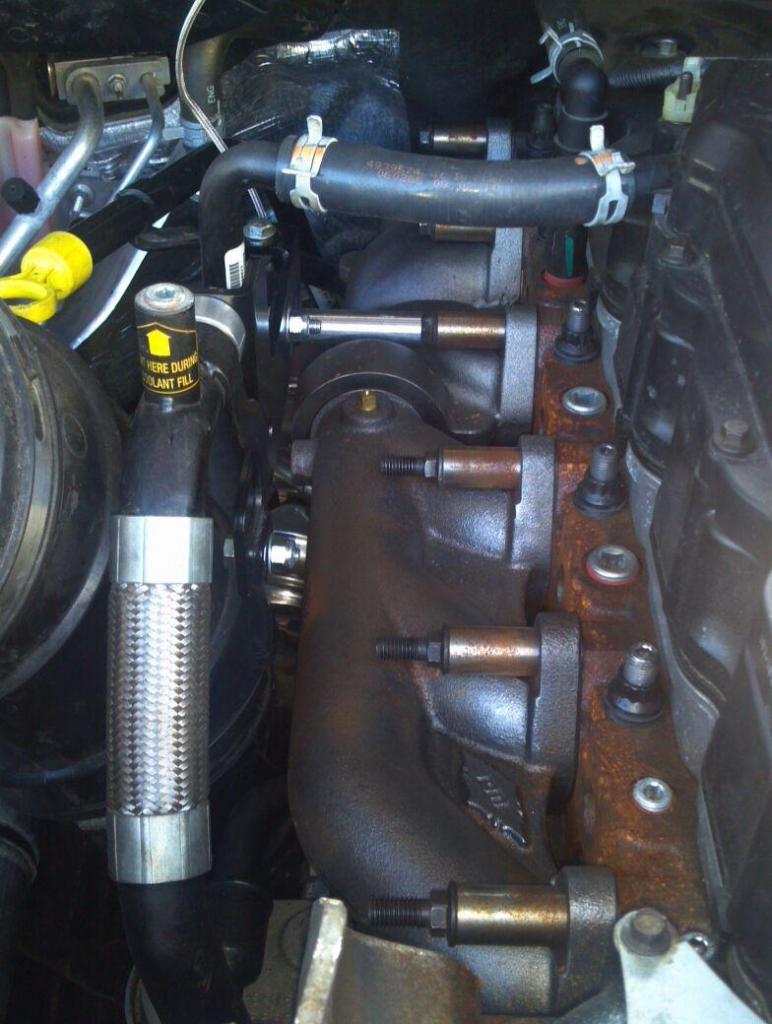

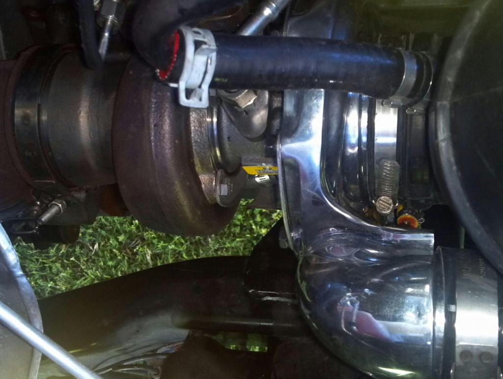

Here is the II SS66 and PDI manifold with a factory intake box. Install was pretty easy with some hick-ups here and there. I will say this, if you have no experience as a mechanic, do not try this install alone or you will loose your mind!!
I will have some test results soon but as of right now I can drive this truck at Wide Open Throttle and never hit above 1200 Degrees EGT. That is running H&S Custom Tune (Hot DARN Aggressive Turbo Tuning) on "HOT" setting.
