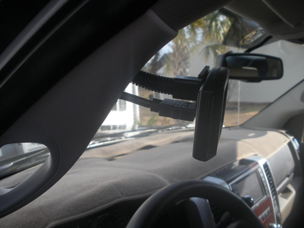

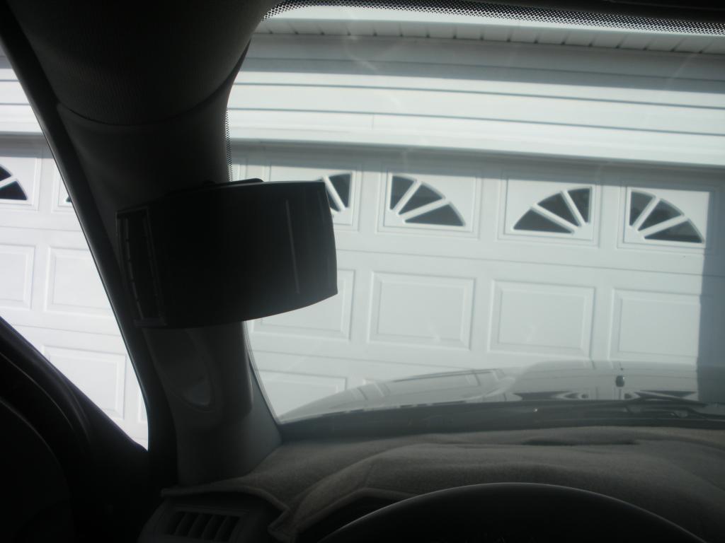

Here you will notice that I simply drilled two holes in the A-Pillar and mounted my Mini Maxx. You can route the wire up from below and cut the back suction cup mounting off of the supplied H&S mount. Routing the metal covered tube from the H&S mount is pretty simple and everything fits perfect. I made sure that the metal tube was braced by the factory mounting holes in the A-Pilar so that I can bend it as necessary.

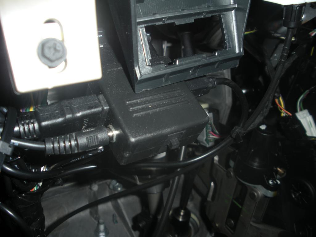

Also, some have relocated the OBDII port so that it is not hanging down as far. Here is a photo of mine. I just pulled the plug out and tie wrapped it up about 3 inches. Make room for my 6'7" frame and size 14 boots. Definately helps. Maybe someone with a little more skill can show me how to make it look purty

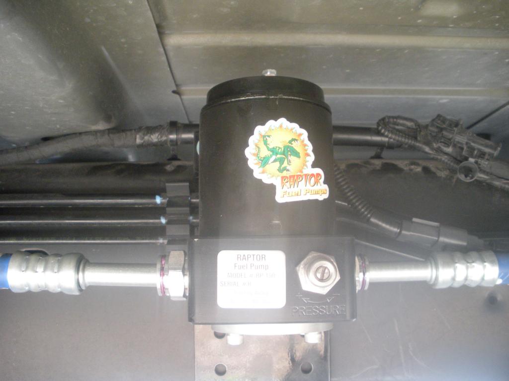

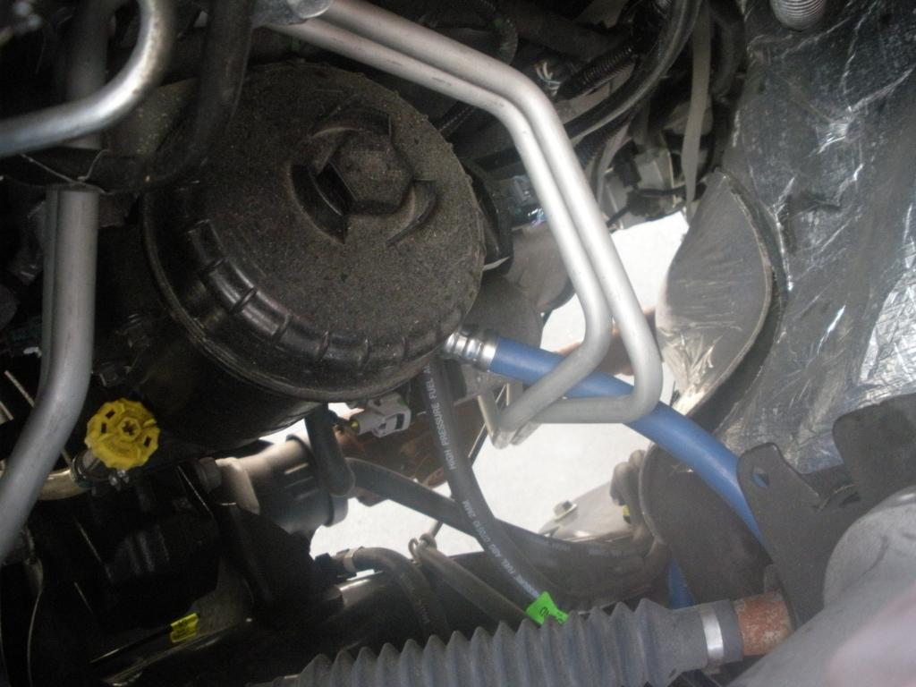

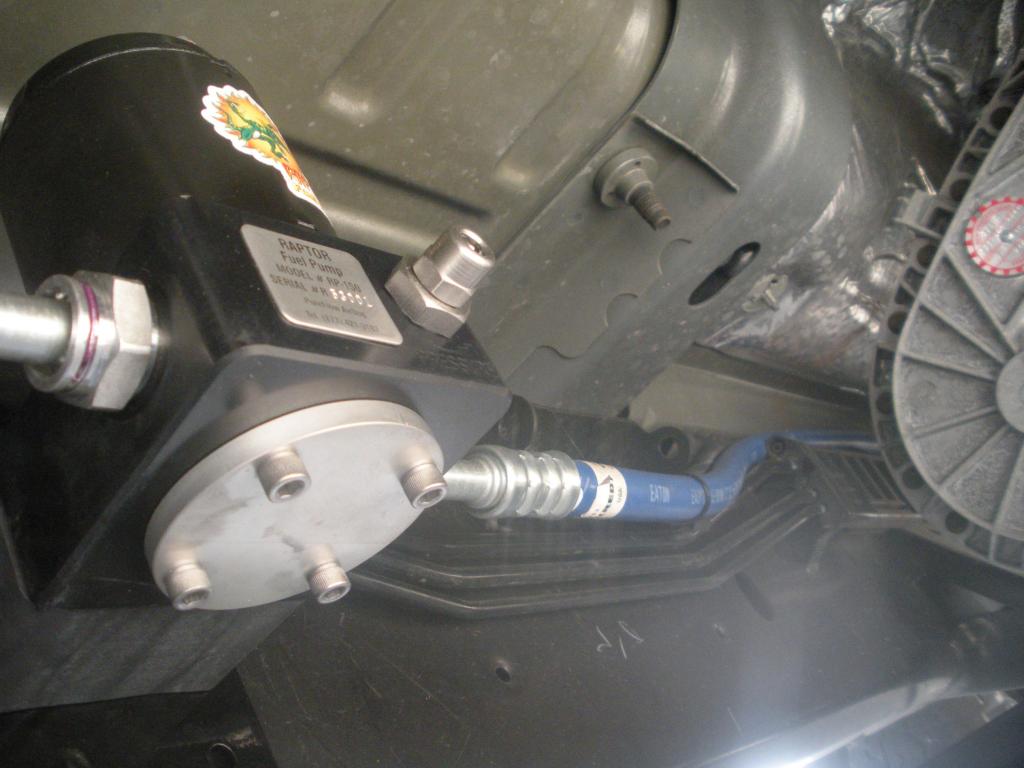

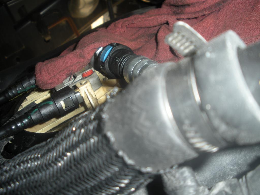

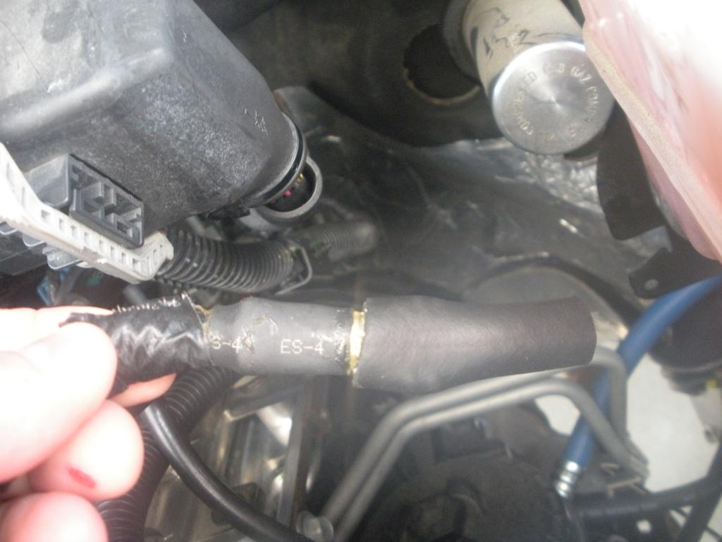

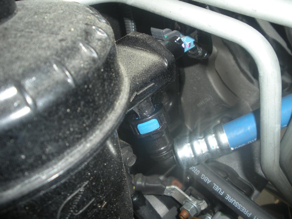

Here are some photos of the Raptor 150 mounted on the frame. The factory tank was dropped and all factory items were removed. The draw straw was then tapped into the tank and all QD's were routed along the factory line location. You can also see how it goes into the factor fuel filter housing.

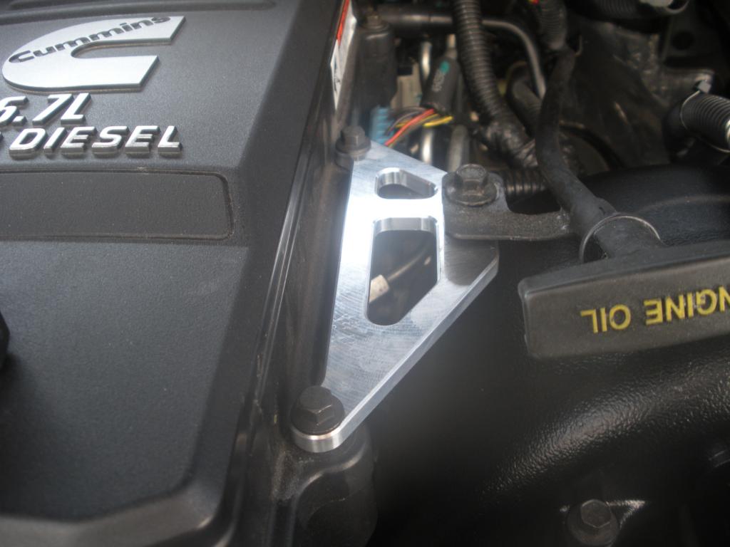

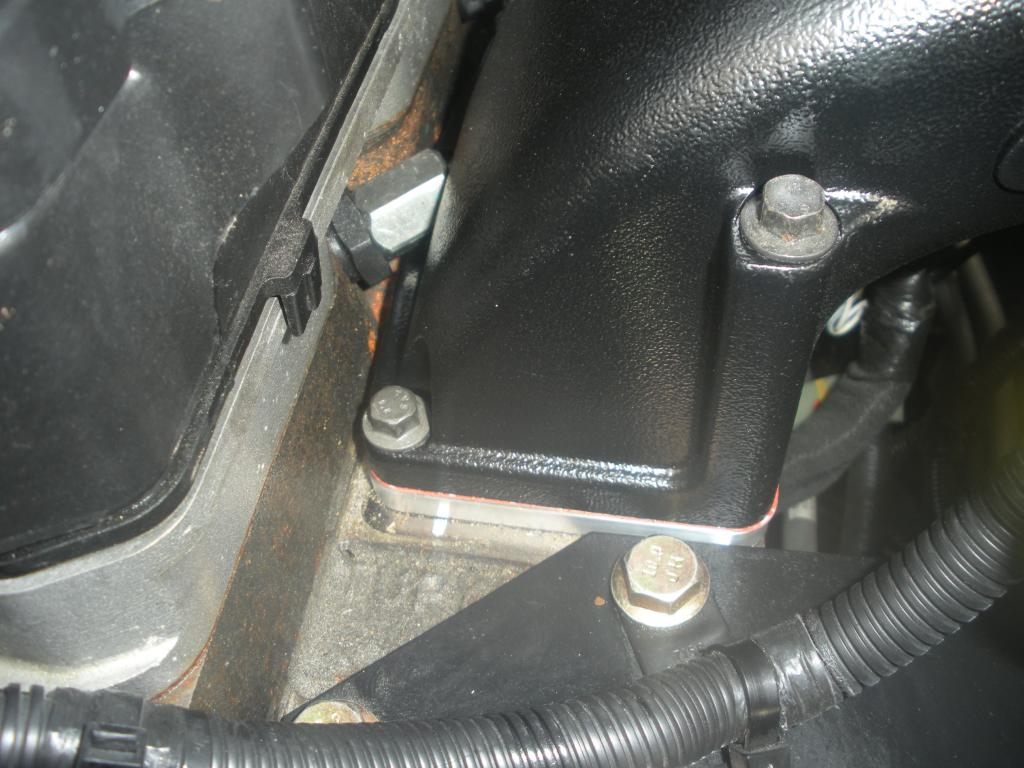

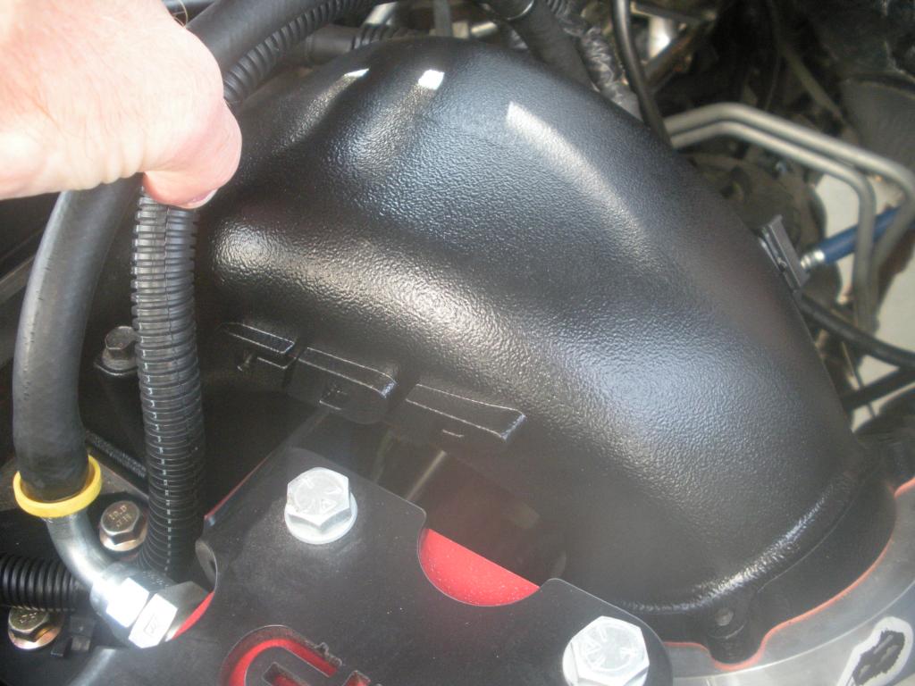

GDP S2 intake manifold and Air Boss 67
I kept the Shibby TV Delete in case I need to add a grid heater later.

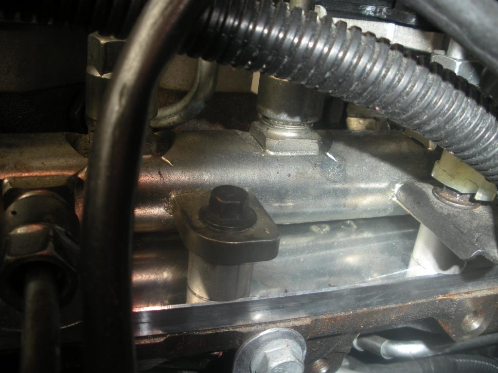

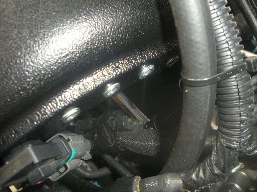

You will notice the fuel rail spacers as well as the pre-tapped bungs for some special accessories if you find the need to add a gage, nitrous, or water meth.

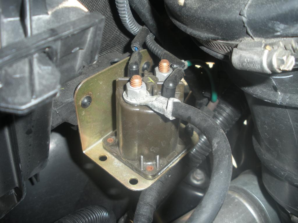

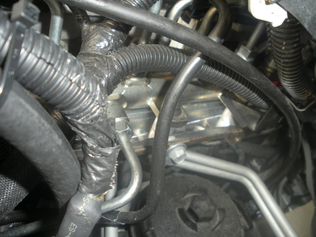

Here is the wiring for the factory grid heater line. The GDP instructions say to disconnect the line from the relay so that there is no risk of shorting that "HOT" wire. Due to the fact that I was unsure about the grid heater, I have the line simply wrapped in hose to prevent shorting.
FOR THE RECORD: I had this work done at TRE Diesel by Tim. He is the one that can take credit for that idea. I would have been the retard that removed the wire and spent hours wondering where I put it.

Thanks N2D! I'm just installing my mini maxx and the photo of the OBD2 box confirmed that there is a problem with the block. My power lead only goes in about 1/4-1/3 of the way, then just stops. I can't see any obstruction, but since it doesn't work from the OBD2 power eiter, there must be a greater problem. H&S is sendinng a new block so I'll be up pretty soon.

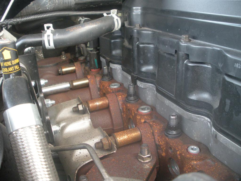

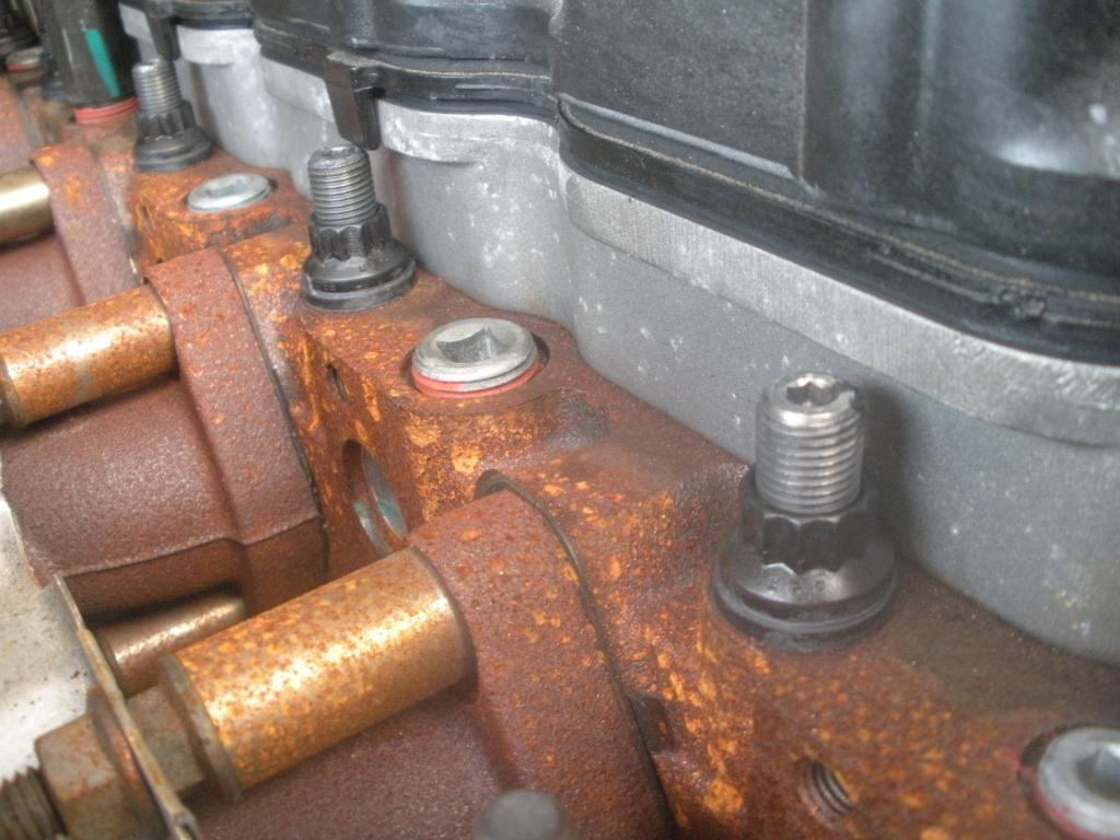

Here are some photos I promissed. Notice the box filled with the old factory studs. Also, the picture of the PN on the ARP Box 247-4204. They also are not the cheapest thing in the world so be prepared to cry a little when you click "Add to Cart."
