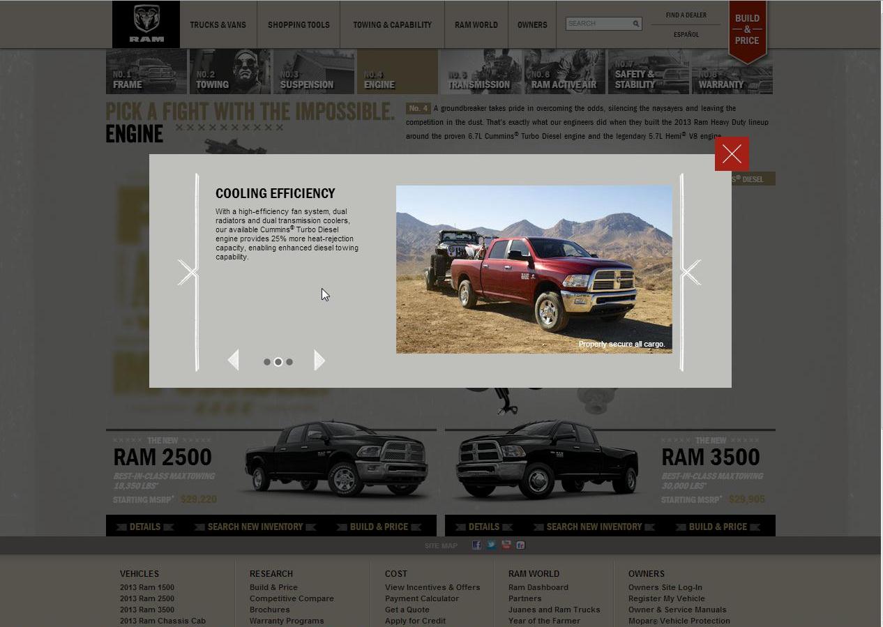

Here is the resulting change because of heat complaints or at least it's my opinion.

I agree the new system is impressive, what I do not like is the dead pedal/heavy torque mangement and unresponsive feel of the 13+ trucks. I also do not like being told in a 2500 the 3.42 is ALL I CAN HAVE (yes it adds to fuel economy but its not a good ratio for a vehice that tows IMO, and adds to that slug feeling). These are the main reasons I eneded up with a 2012. Ill take some added heat as long as its the norm, and this truck gets it when I push the accelerator.
