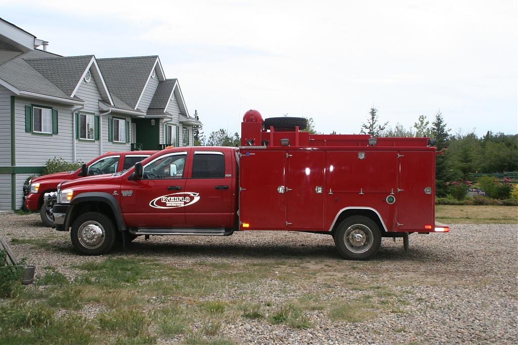

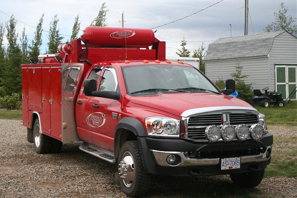

I have about 6500Kms on my new service truck. It is a 2008 5500 6 speed manual with 4.44 rear. I have a aluminum service body and V-mac air compressor installed. The truck does idle for 8-12 hours a day. When the air system is turned on and the demand for air is heavy the exhaust filter is able to remain clear. When the air compressor demand is low the DPF will plug up in about 6 hours. The filter has finally filled 100% and the overhead consol reads "power reduced see dealer".
This truck must idle alot in order to keep warm in -35"'C winter weather.\
I am happy with the truck on the whole.
I am seeking a long term fix for the DPF plugging problem.
Others in this area are just removing the filter and adding chips. I am told that fuel econ is about 18MPG post mod.
I would prefer to remain 100% stock but if the filter keeps plugging and Mopar cannot fix the unit I will have no choice but to remove the filter in order to remain working.\
Any one had any success with extended idling situation with the factory situation.
The only other thing I would change on the option list would be to not order the Super Heavy duty front spring package. The unit runs very rough off road .
It also follows the highway ridges at highway speed. I believe the later is from incorrect wheel alighnment. I have not had a wheel alighnment. I am asuming that with different chassis weights the alignment will change?
Any thoughts?

It will always do it unless you remove the DPF,which is easy to do on a C&C, oh btw since we are in Canada we can talk about DFP delete's all we want.
You only other option is to drive it on the highway for about 45 min a day

What a great looking truck! I really want one now. Nice to see one with a manual trans, I have not seen to many.
