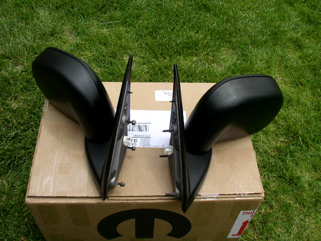

Lots of single tow and non tow power and non power Ram mirrors for sale on e-bay. New and used.
Cheers
Mike
