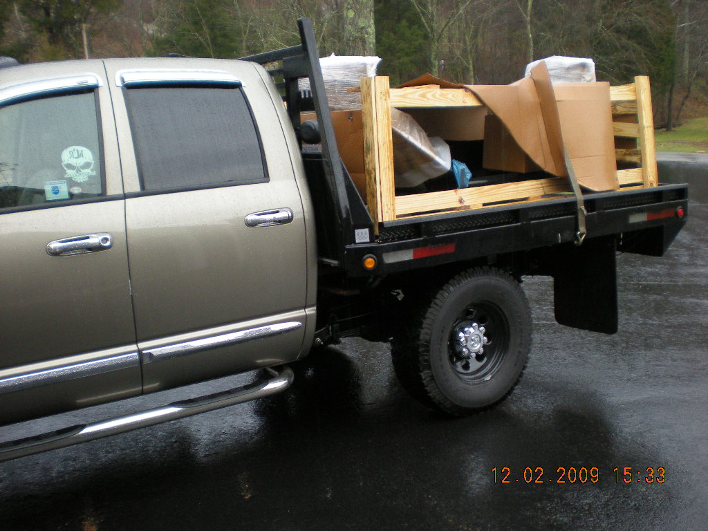

Not sure if I added the pics correctly. Here goes
Attached Thumbnails Ranch Hand Grill Guard Installation-005.jpg   Ranch Hand Grill Guard Installation-006.jpg
Old Jan 19, 2010 | 10:23 PM
nibroc's Avatar
Posts: 65
From: the 'ville, kentucky
mine was dinged and bent pretty bad when I got it home also--but after my madness I straightened it out and touched it up a little---
Attached Thumbnails Ranch Hand Grill Guard Installation-front-bumper-008.jpg
