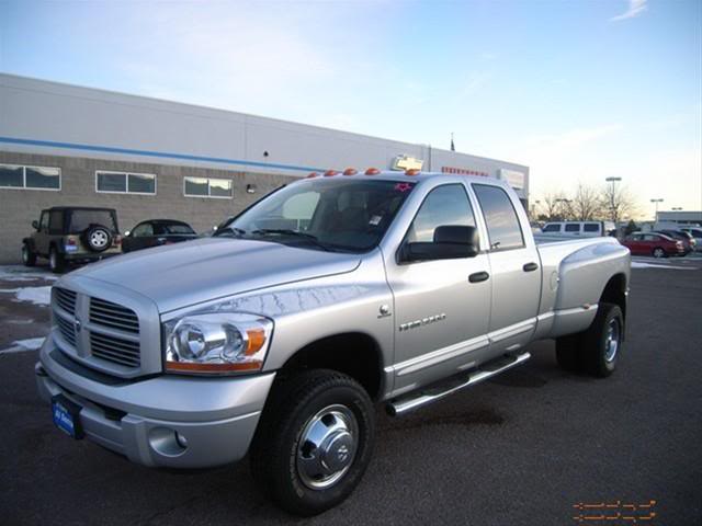

I converted mine... I took my mineral gray 2500 down to the dealership and had them convert it into a bright silver 3500 dually!!
I'll bet they even zeroed the odometer for you......Ben

[QUOTE=kaywt;2713595]I converted mine... I took my mineral gray 2500 down to the dealership and had them convert it into a bright silver 3500 dually!!
LOL ! Quite a nice conversion!!!
