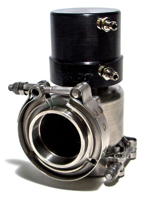

Sorry about the delay.... Here is a link to the wastegate I was referring too: http://www.jgstools.com/turbo/index2.html

Yep, I like it....my Tial would always leak above 50psi....the 2" vband connections make removal a snap...If it was good to 120psi...I'd be very happy. ks

I've got a few of those laying around . They are massive compared to their 40mm though. The race trucks I'm building will use those.
