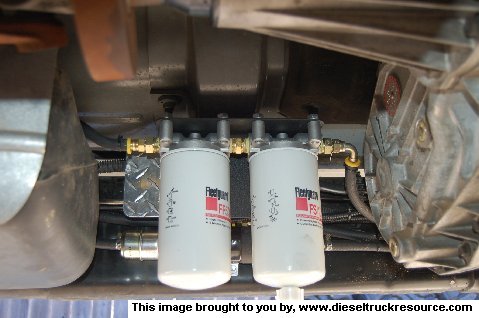

This is a pic of Greyrig05's filter setup. I have the same bracket. It works real good. Pic does not do it justice!
Old Oct 25, 2007 | 09:06 PM
mm73's Avatar
Posts: 343
From: Louisiana
that looks really really good.
