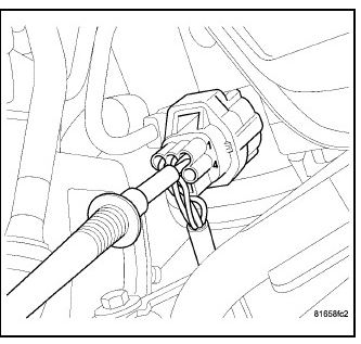

There is also a way to turn your factory fan on with a switch. You tap into wire at the connector located under the radiator left side which goes to the fan clutch. You just need to ground one wire at the connector pin #one and the fan clutch will lock and go to max flow. It will take a few minutes for the clutch to lock, it doesnt happen immediately.
