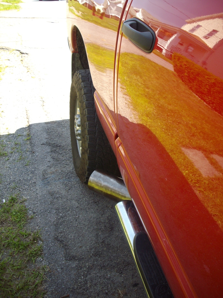

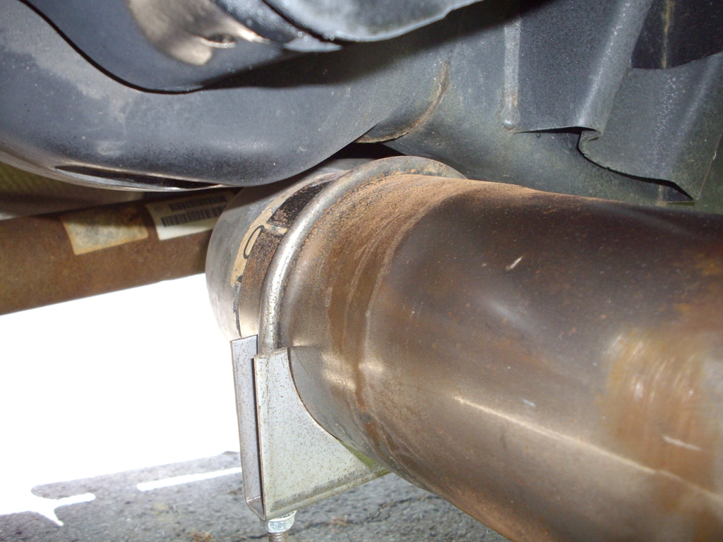

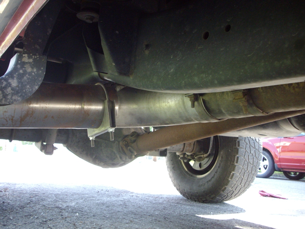

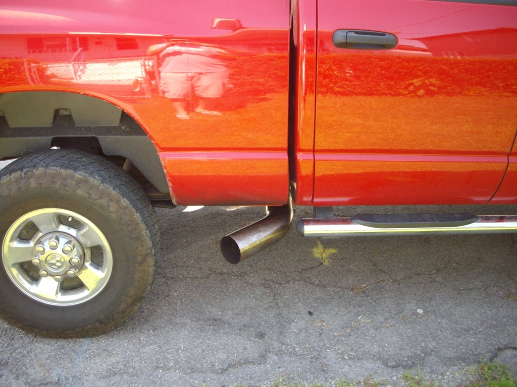

Old Jul 5, 2011 | 09:13 PM
07BigHornRam's Avatar
Joined: May 2010
Posts: 168
From: Scranton, PA
As requested. Sry it took a while.

Old Jul 7, 2011 | 06:53 PM
rjg23's Avatar
Posts: 83
From: Bellemont/Flagstaff, AZ. Near Pilot #180
That is really cool, thanks for sharing. I didn't even notice that little hump in the frame, I'll have to see if I have it on my LWB and where it falls. I figured I would 45* out right off the pipe, but you had a good solution there with the 90 to 45. Thanks again.
