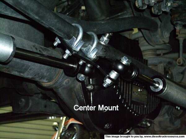

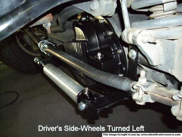

Ok....got the dual stabilizers installed over the weekend. Everything fit great and plenty of clearance with the Mag-Hytec cover. Hope I posted the pics correctly.
What do ya think?

Thanks for the pictures! Initially, it looks a little odd with the driver's side stabilizer being offset further forward, but I guess it's to gain clearance for the MagHytec?
Is there any difference in how the steering feels? Do the radflows come pre-charged?

Yeah the offset threw me off a little at first too, but it turned out to be a very nice set up. It seems to be the only option to run duals w/o fabbing a passenger side bracket to match (w/ the Mag-Hytec cover). I used to have BDS duals which are similar to Bilstein prior to the new cover. The Radflo are a bit firmer and keep the front end tight and straight. Not a drastic change from my previous duals w/o the cover, but I went ahead with the new shocks anyways. Definite improvement over running a single. They do come pre-charged. I can't recall the exact pressure, but I didn't have to make any changes as shipped.
