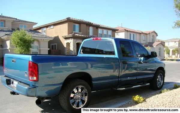

forget 20's Go Big 22's On 37's You Cant Go Wrong.
Attached Thumbnails 20 inch rims what size tire?-1028699_12.jpg   20 inch rims what size tire?-1028699_4.jpg   20 inch rims what size tire?-1028699_34.jpg
