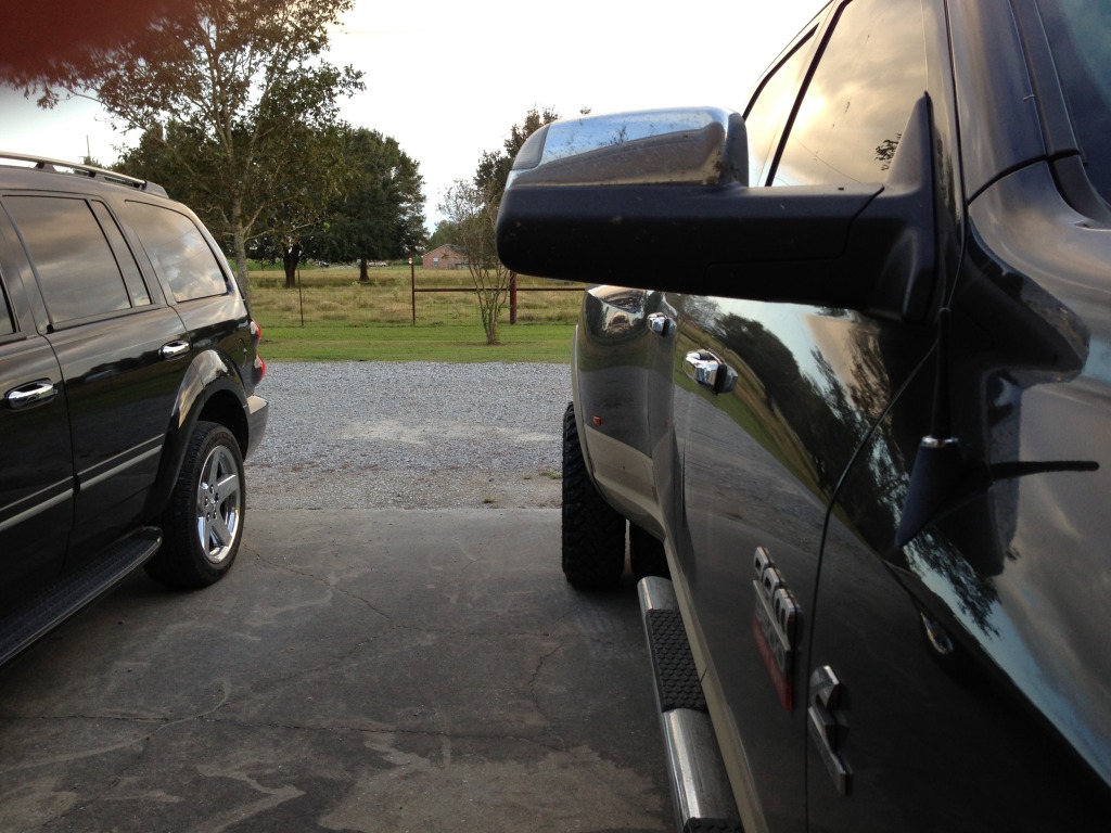

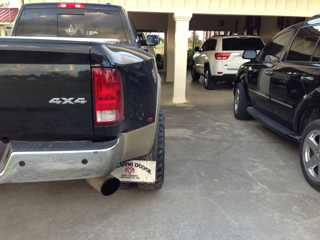

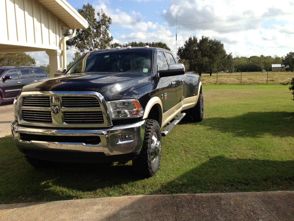

285/75/17 Open Country MT's on the stock 6" dually wheels.

By the way.....very nice looking rig you have there Blake.
