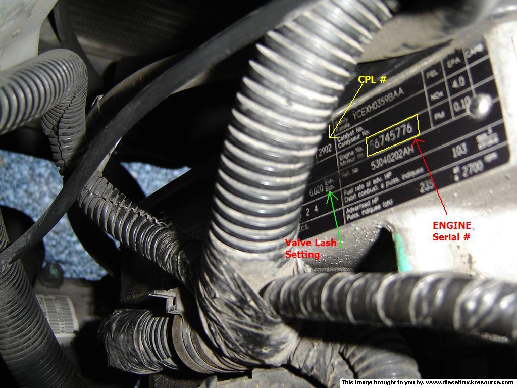

Valve clearance specs are ALLWAYS on the Dataplate on the valve cover.They've been .010" int. & .020 exh. for every cummins B series for the last 10 years +/-.

Nick and Bigwheels both are telling the true story. Nick's values are right out of the manual, and Bigwheels are right off the decal on the valve cover

It is also written on the data plate on the timing case at the front the engine.
