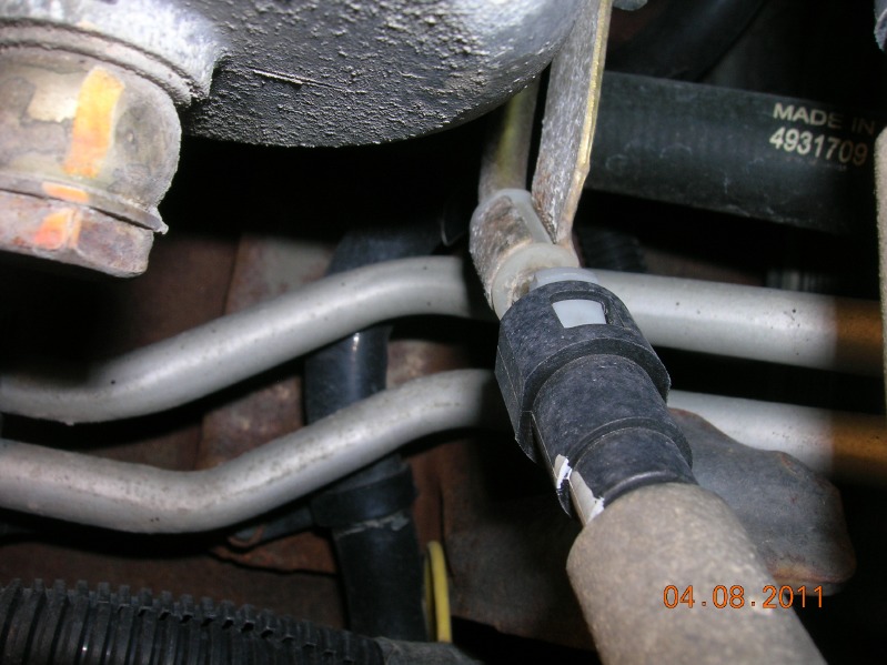

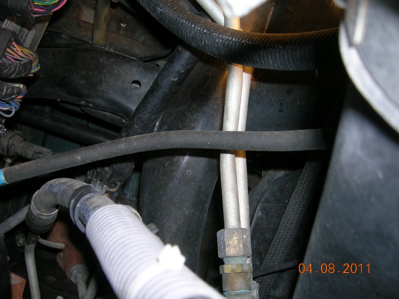

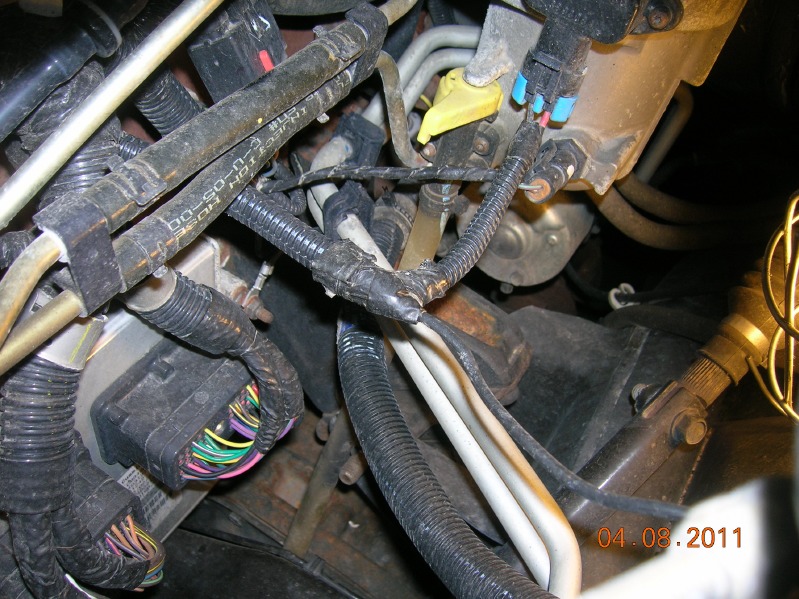

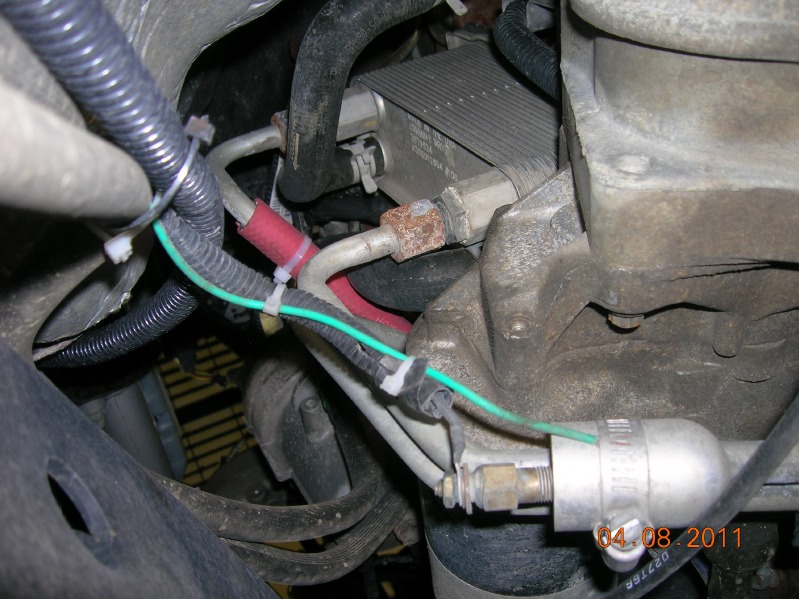

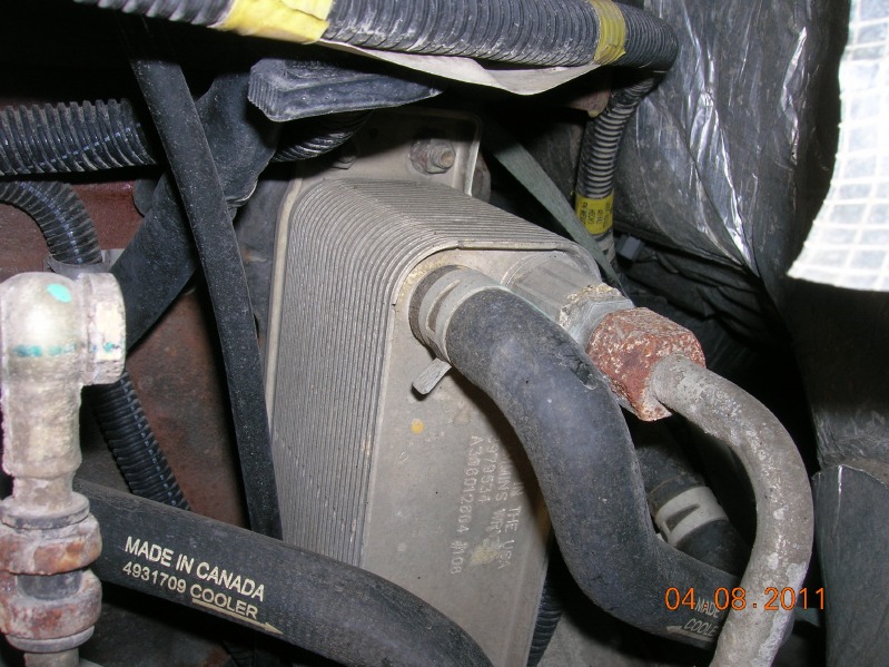

I'm gonna have to admit, I can't find a plastic line, I looked everywhere and atleast made sure the lines weren't touching. The blowby tube was the only thing close, everything else appeared ok. Maybe they changed this on 06's? or the previous owner did. Heres a bunch of pics. Let me know if you see anything I'm missing. I did the red heater line hose a while back, there wasn't any rub marks, but I covered it to make sure.
Thanks,
John.

Excellent shots.
On your trucks, the rubber line to the bottom left ( in the picture) of the heat exchanger, is the problem on this 05. However. On this particular truck, the line is actually plastic ( or phenolic ) and is joined to the lower port on the heat exchanger by a rubber elbow and two spring clamps.
All the trucks I have checked so far ( 03 - 07), have a plastic line with the rubber elbow and spring clamps. As curiousity and time permit, I will check other ones and see how many of each I find.
