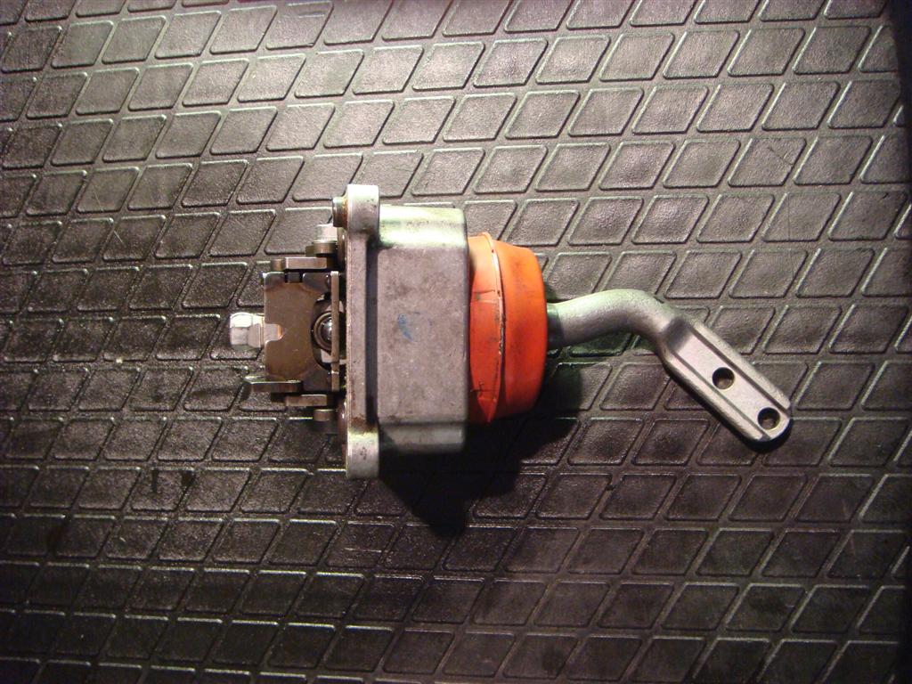

That makes sense - sometimes you can smell the +4 aroma getting past the shifter seal at speed.
The 2-piece shifters do make it easy to mount a custom shift arm.

Hmmm, what could we bolt on here:
