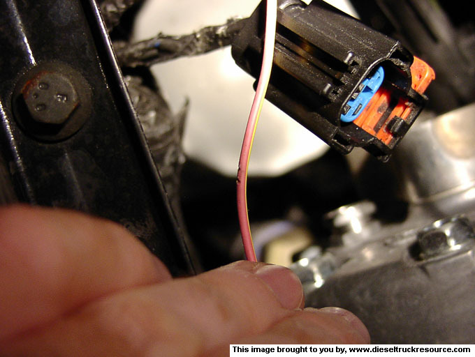

Originally Posted by Windscreen
I had this same problem on my truck back in July, only it "fixed" itself and wouldn't reproduce when at the dealer. Despite a laundry list of codes, the dealer insisted it was bad fuel, probably water (that somehow was only bad for a few minutes). Someone else on the TDR reported a similar problem so I went looking at the wires by the AC compressor. After unwrapping the electical tape on the harness going to the AC refrigerant pressure sensor (3 wire bundle) I found:
two spots where the +5 volt line (pink w/ yellow tracer) had been rubbing against the AC compressor. I could just see where the insulation had just barely been worn through to contact the wires and short out the PCM +5 volt supply.
The big connector in the picture is the 2 pin that controlls the AC clutch. The wires in question do NOT go to this connector, but a 4 place connector (only 3 terminals are used) just off the bottom of the picture. For reference, this shot is under the truck, looking upwards. The blurry white round thing is the oil filter, and the silver unit is the AC compressor. I had both AC related connectors disconnected as it freed up the harness to work on and repair.
Reposting with the picture link fixed. Apparently got trashed in a forum software update.
-Steve

I don't see the picture of the problem AC wire, can you repost this guys, thanks
Reg
