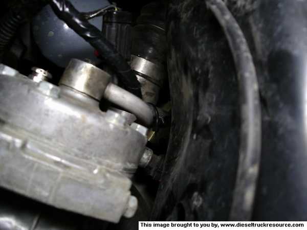

I fixed my wire rubbing issue tonight, I took some convaluted tubing (wire loom stuff) and tucked the wire into it, I then double wrapped it with electrical tape and finished off by securing it to the AC line by the pressure switch with a zip tie just to prevent it from rubbing,
This picture is from under the passenger side ooking up, the big round grey thing is the oil filter and to the right of the picture you can see the wire has been re-routed and zip tied to the AC line'
It was a matter of time before this would have been a severe isue, thanks everyone for the heads up!

Here is the picture reposted....there are other pics in my gallery
You can see the oil filter and AC compressor. The wire in question is the one with electrical tape and you can just make out the zip tie securing it to the AC line so it doesn't continue to rub even with convoluted tubing and tape. Mine was definitely showing signs of wear but not to bare wire yet. Others have reported some driveability issues when it rubs through.
