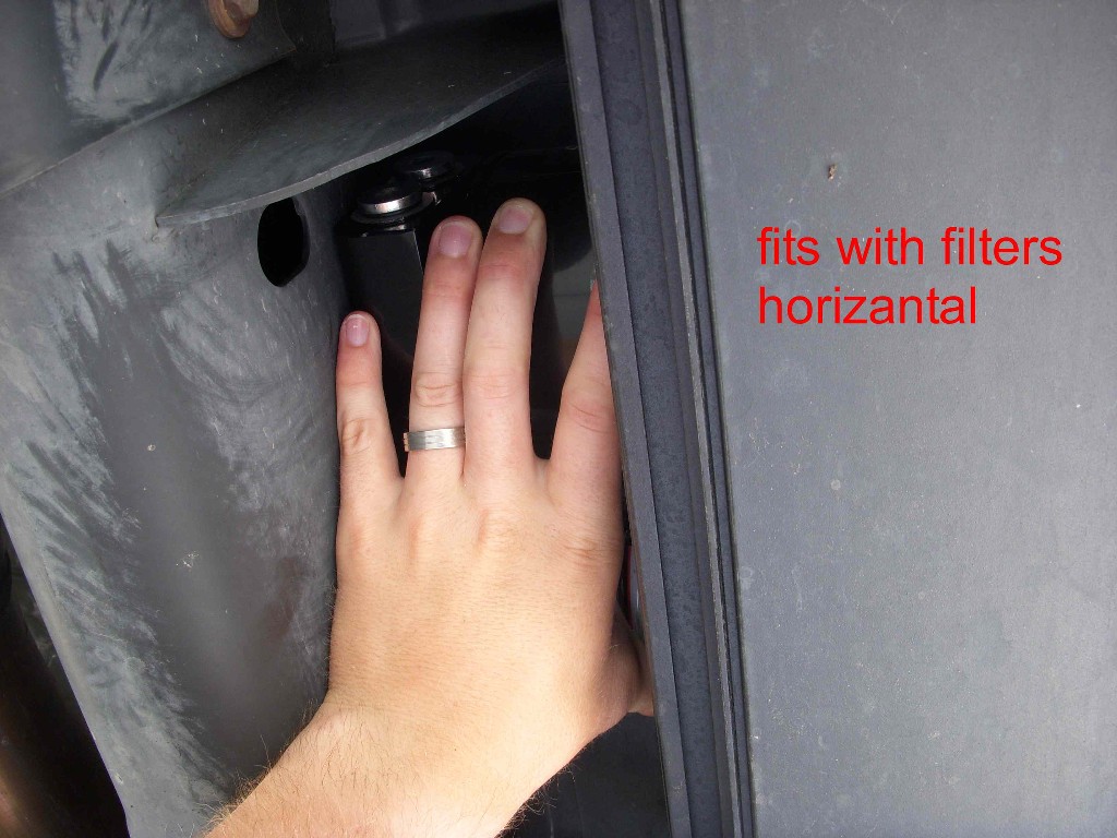

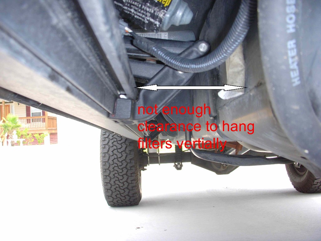

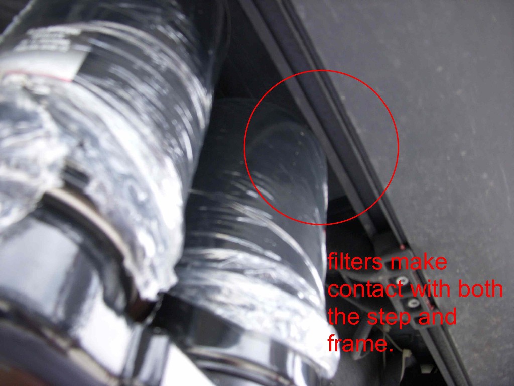

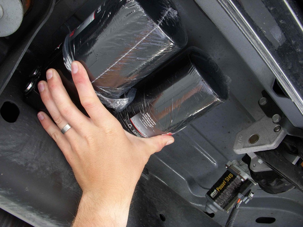

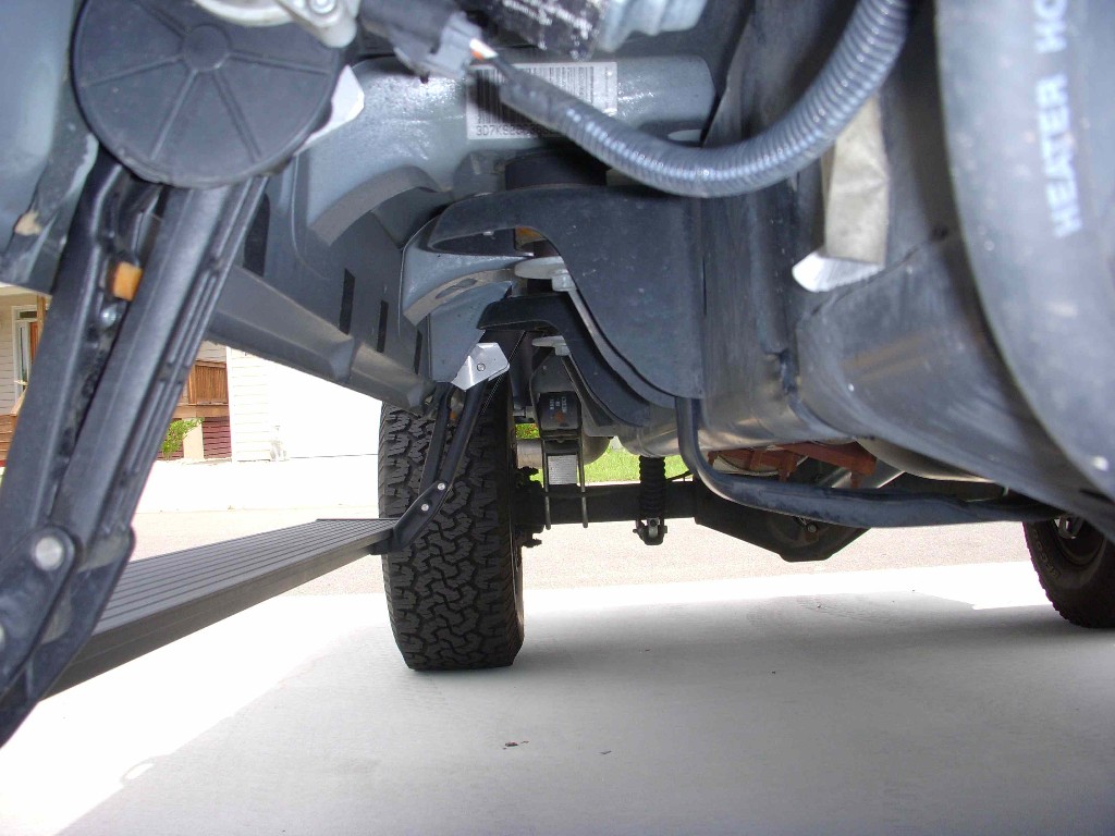

Well, I have been out laying under my truck trying to figure out where to put my dual remote bypass filters from Amsoil. I have already fabbed up a steel bracket that makes use of the threaded holes near the exhaust manifold, but that wont work because it strikes the hood when I close it and I cant shorten the bracket(filter length). Doesnt look like it will fit on the left side of the engine either. My biggest question is how far away from the engine can a sytem like this be mounted? The documentation says as close to the engine as possible. I have included a couple of pics, unfortunately, my electric steps use up most of the usable frame rail unless I mount the filters horizantally. Do you think that would be a good way to mount, if so, the steps would provide some protection when not extended? My preference is to mount them vertically so that I can fill the filters with oil during changes, but to do that they would be located farther from the engine, I cant hang them vertically on the frame near the steps or the will get pinched.

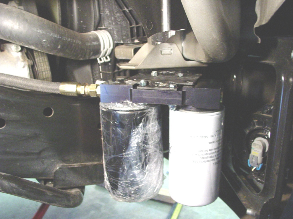

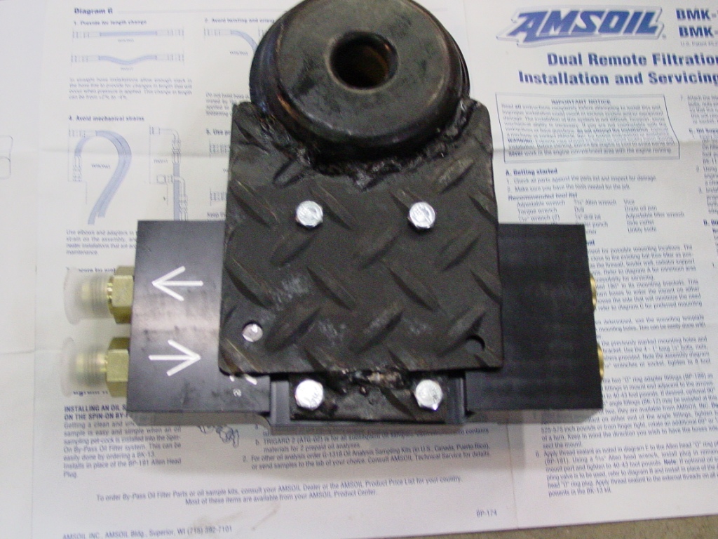

Hi,
I installed one a few years ago on my 2004.
I found a nice spot behind the front bumper that allows the filters to be vertical.
This orientation minimizes spillage and I have excellent access for changing them.
If you remove the right front fender liner you have access to do the work.
I did have to trim a bit of the lower front corner of the liner to clear the filters.
One thing that I had to do was use rubber isolators between the filter mount and the truck chassis to control the noise from the oil pump.
I hope that this helps,
Jim B

You are correct about the bypass that I used not being recommended by Amsoil. In my case I really wanted to relocate the filters to a friendlier location, and in 2004 I was not aware of the recommendation advising against using this system.
My installation allowed for very short hoses (20") and straight fittings. When I first started it it sounded like I had a tractor with low hydraulic fluid in it. Then I figured out that the mount was transferring oil pump noise into the chassis. Once I installed the rubber isolators to replace the mounting bolts it completely solved the noise issues. I have not had any cases of codes set or indication of oil flow / pressure issues. In my installation the old mount has worked out fine.
I would not use my apparent success as a recommendation to anyone else to install this older system on a 3rd gen.
Jim B

Thank you guys for the help. Especially you Jim B. That location you described was perfect! I fab'd up a bracket and now just waiting for the paint to dry. The kit that I am installing is the BMK-25. I will post photos on this thread tomorrow after final installation.
