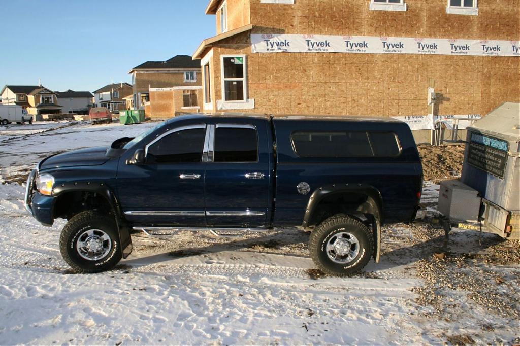

i'm running 37''x12.50 on my stock 17" rim BFG AT's on a 6" suspension and 3" body lift.
I need a different rim though to get some backspacing because I still rub a bit at full lock .
The look is a toss up ,some guys think they should stick out further from the truck while others like the tucked in look .
I like it but I think a little wider stance would be good
