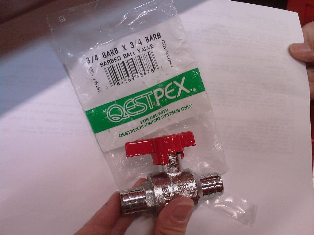

Before I got the valve I have now I had a few different types of ball valve. They all leaked at the pipe threads. The valve I have now is a PEX brand from Home Depot and the pipe threaded ends were installed when it was manufactured. It has not leaked at all. Somewhere on here there is a thread where I posted a photo of the valve I have now.

Go to home depot. Here is the valve I am using and have used for a couple years now.
Attached Thumbnails AC heater hose mod, months later it leaks.-imag0130.jpg   AC heater hose mod, months later it leaks.-imag0132.jpg
