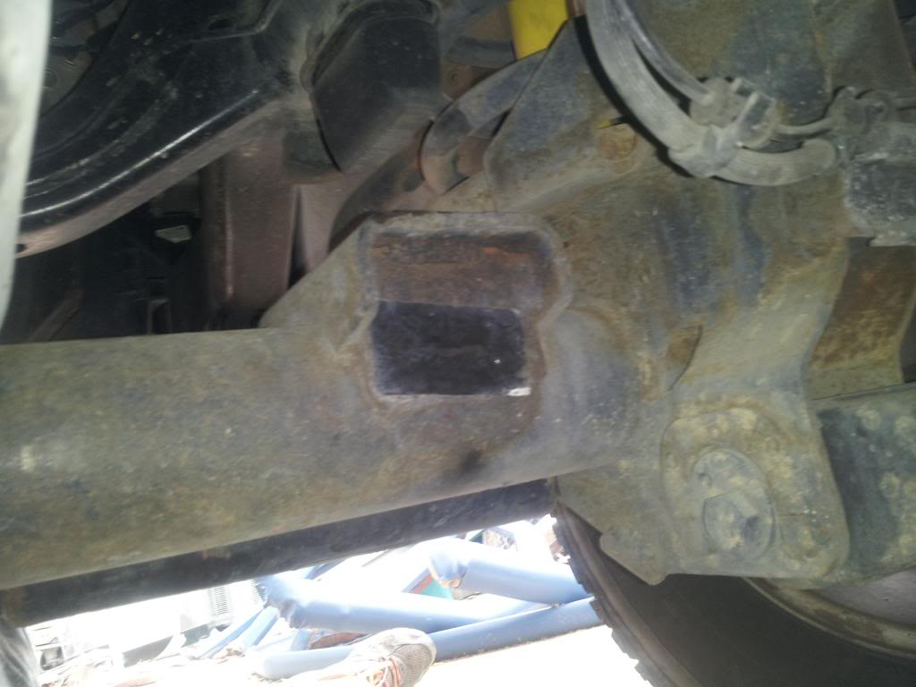

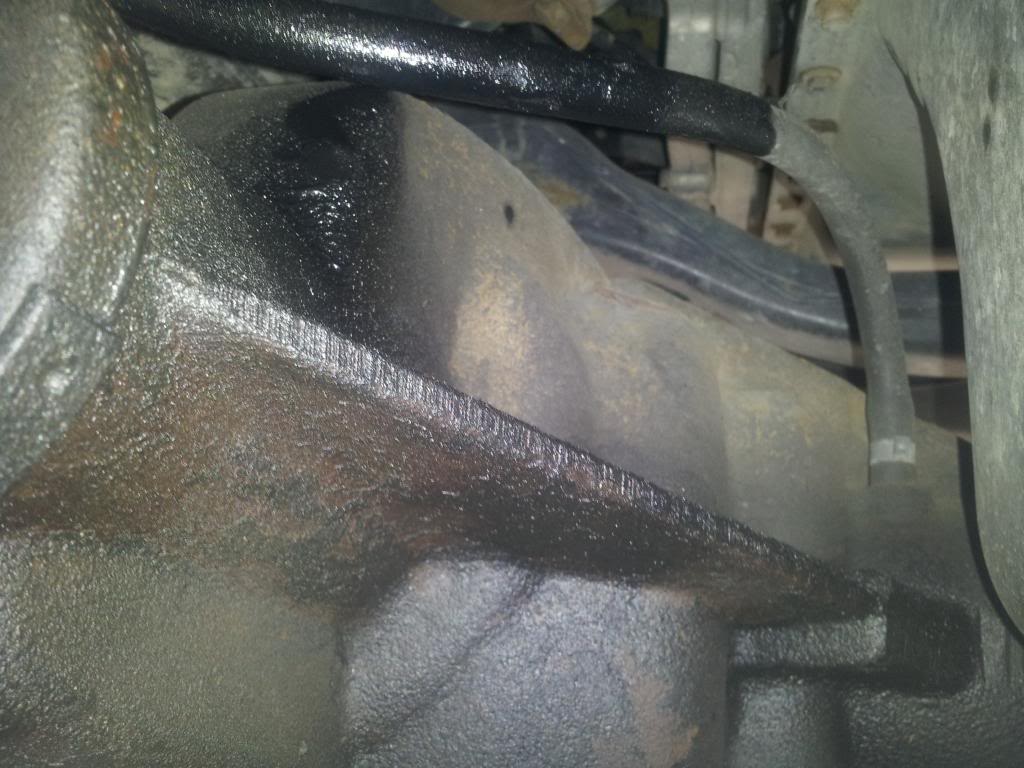

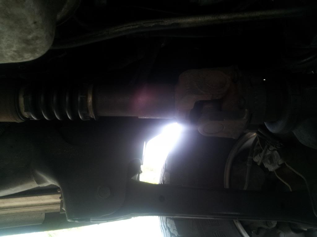

Here are 3 pics I took. The back side of the long axle shaft, front end of the front driveshaft and a hose that I just noticed going into the top of the case.

Pic 3 is the axle vent tube and the plastic cap on the end should be placed as high as possible to keep water and debris out.
You axle shafts are always spinning. The transfer case is where the disconnect is. Which means that when you are driving in 2WD your front drive shaft and axle shafts are still spinning but with no power applied.
If you were hearing clunking from the front end it could easily be the axle u joints. They connect the axle shafts to the hub shafts which allows the tires to turn. If that is the case you need to replace those.
