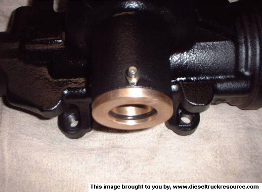

It's nice to have your own lathe. I made a brass bushing for my steering gearbox. Notched it out for an o-ring, and drilled for a grease fitting. Pressed in fit for the gearbox, and .003 clearance on the sector shaft. Nice and tight now. 03 track bar and heim joint steering fixed the rest. Don't even need a steering damper with 37" tires. More pics in my photo gallery.
Brad
Old Jun 15, 2005 | 01:27 PM
RAW FUEL's Avatar
Posts: 76
From: Vale, NC
Sweet! So this fixed the slop in the steering box, huh. I will put my uncle and his machine shop to work for me. What is this heim joint? Had a farmer friend here that had to replaced some joint down in the steering column, is this it? Mine has a small pop to it every once in a while.
