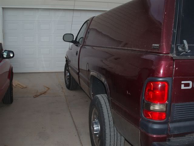

i removed the spacers and installed '04 2500 wheels and a bed off a '95 2500 and that's all for my conversion from a dually
