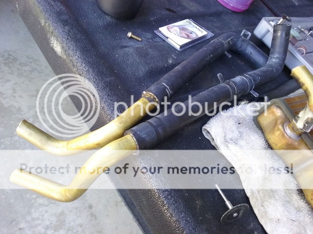

I never posted back but I recently re
Here's some pictures to help understand what I described above.....
This was as far as I had to move the dash back.
Here's the old core tubes cut off with the heater hose still attached.
The new core wrapped with foam.
The new core tubes spliced back together with heater line and constant tension hose clamps.
How they look sitting back in the truck.
This is a top view.....but just note that the new core is not fully seated in its spot, nor is it clamped down or the ground strap put back.
Well worth not having to go through all the trouble of removing the center console, unplugging all the wiring and vacuum lines, removing the dash, evacuating the freon from the HVAC system, disassembling the AC lines, and removing the heater box away from the firewall. But again, to each is own.
