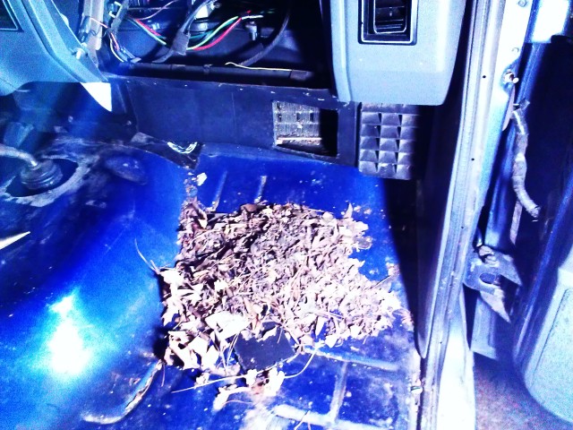

After reading some of the FAQ/How do I....? articles I decided to clean of what I could see poking out of the box. I have caught 2 mice with some glue strips already this year so I figured there would be some debris in the box.....but really?
I can already feel the Hanta virus coming on.....

Excellent floorboards though.

Maybe I should cut a hole in mine.

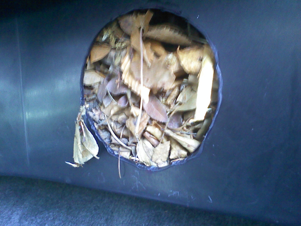

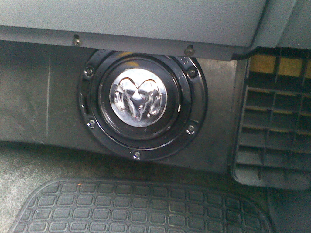

Here what mine looked like was well worth doing it. A lot stuff in the heater over the years. I cover the hole up with plate now unscrew and clean out if I need too.

Where'd ya find that plate??
nice job..

Yep, parking under trees is bad for A/C. LOL I had the same mess in mine. The last time I checked it she was clean.
nice job..
Thanks. The plate I used don't laugh at me. I went to ace hardware found a toilet bowl flange that you screw to the floor. It was a metal one bought it cut the plastic pipe off the back painted it black. The ram in the center was from my center caps from the front one that I had to cut to slide over the front hub. So far not one person that see it knew that is was a toilet flange. Worked for me.

Laugh at you ?????
Why I think you're Brilliant !
If you're ever in a pinch, and need to pinch, you have the perfect solution of where to go... and, best of all, not one cop passing by your truck would ever think twice of what you're doing down there..
You're a genius. I wish I thought of that ....
