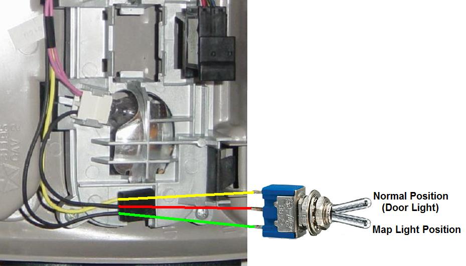

Toggle switches
Both of my overhead map light switches are broken. I was planning to just replace the switches with a couple of toggle switches.
I see 3 wires in each existing switch, but a single pole single throw switch has 2 terminals.
Does anyone have a schematic of the wiring harness in the console? I'd like to see what kind of switch I will need and how to connect it.
Old Feb 8, 2007 | 10:57 PM
AggieJustin's Avatar
Joined: Jul 2002
Posts: 2,242
From: Celina, TX
Pink - +12V
Black/Light Green - Ground when switch is on
Yellow - Ground when door is open
Old Feb 9, 2007 | 08:58 AM
y2kram's Avatar
Posts: 91
From: Phoenix, AZ
Toggle switch
Thanks! I was thinking last night after I posted that the second circuit was the door light. So what is needed is a SPDT toggle switch (single pole dual throw) ... On - On
Old Feb 9, 2007 | 02:31 PM
y2kram's Avatar
Posts: 91
From: Phoenix, AZ
SPDT Toggle Switch
Here is a solution: SPDT switch (Radio Shack $3.79 ea)
https://www.dieseltruckresource.com/...1&d=1171052754

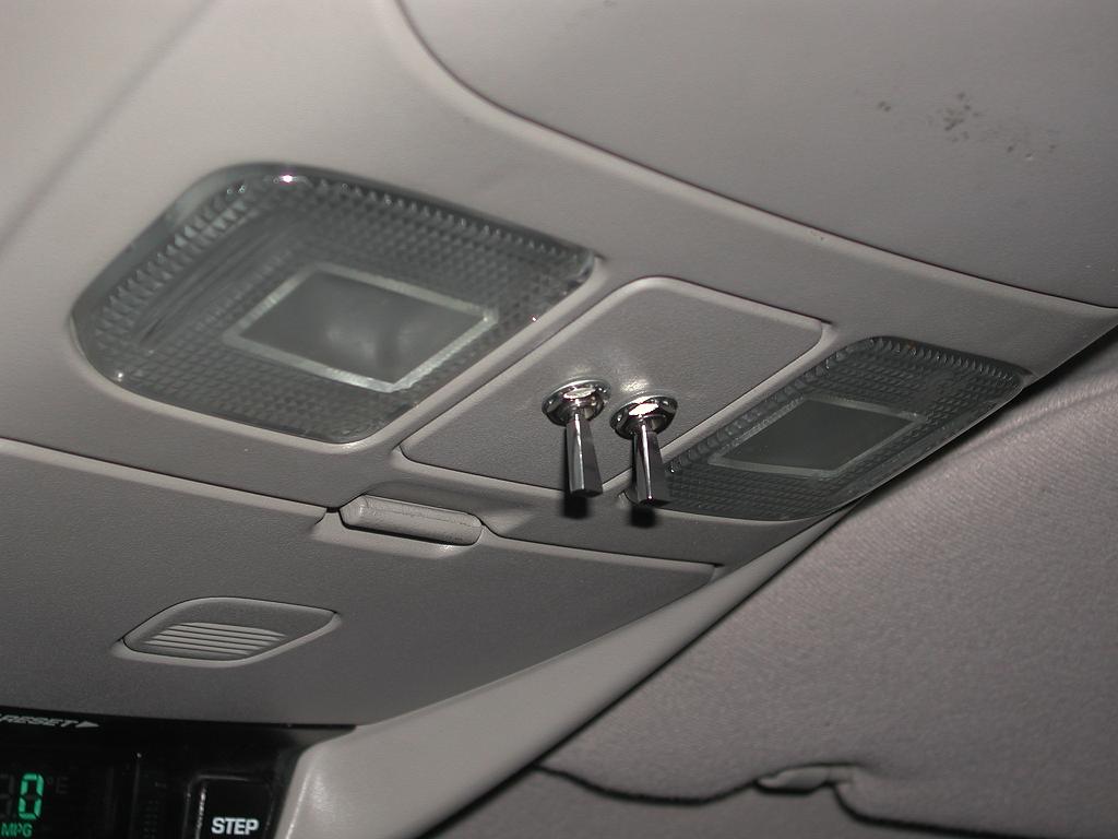

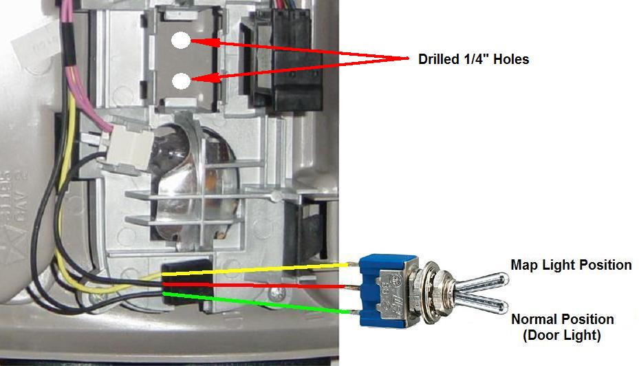

Installed
Actually I labeled the switch positions incorrectly for the connections. This is how it works... And here is the installed picture.
