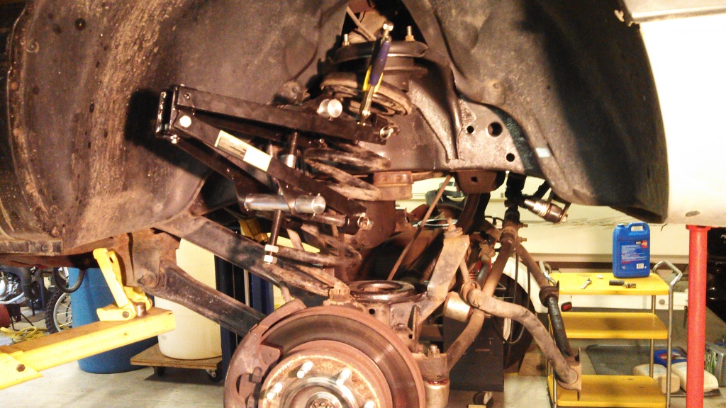

Old Dec 2, 2012 | 03:02 PM
joem's Avatar
Joined: Jun 2011
Posts: 855
From: Brightwood, Oregon
they are tough to get in, axle dropped as far as it could go and spring compressed so far i wore my dirt bike helmet and chest protector as i placed it back in!

Old Dec 2, 2012 | 06:11 PM
missouriman's Avatar
Joined: Dec 2009
Posts: 147
WOW, please share how you got that ball joint out!! I had a shop say they could not aline my truck because the ball joints where shot. they showed me, and they were shot... I hear this helll of a noise and I am thinking I hope that is not my truck. Look out, yep, my truck. he had some thing that looked like a small jack hammer up under there to get them out. there is no way I could have ever got them out at home with my own tools. 850 for 4 of them. I thought I just got screwed.. but then I saw the joints ranged from 150 to 170 each. so like 200 in labor, with the front end alinement. I looked at the old ball joints.. no way could I have gotten them out..
Old Dec 2, 2012 | 08:27 PM
cromulius's Avatar
Posts: 406
Inside spring compressor, got it. Thanks
I forgot to rent the fork to separate the knuckle from the control arm so I cut the ball joint with the reciprocating saw then used the press to remove both ends. I wish the press was smaller so I could have gotten one of my impacts on it but no dice. I turned ratchet by hand with a pipe on the end. The advanced free rental press with mandrels did great. A single ball joint swap should be a one hour job. I had a helper but it could be done solo.
Old Dec 2, 2012 | 08:35 PM
hounddogks76's Avatar
Joined: Dec 2009
Posts: 298
I hear ya joem......my butt was puckered also!!! haha
