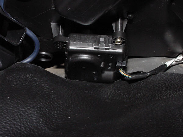

The motor that operates the blend door is located on the passenger side, just about where the passenger's left foot would be...it's is next to the transmission hump...it is about 2 inches square x 1/2 inch thick, a small wiring harness is on the right hand side and is held in place by two phillips head screws on the bottom of the motor. The shaft on the blend is inside the shaft coming out the top of the motor. You could possibly wiggle the motor shaft without removing it but that would be very risky...ALL the small gears in the motor are PLASTIC...if you break or mess one up, you are out of luck. I will post a photo shortly.
Old Dec 9, 2006 | 10:38 AM
Break Away's Avatar
Posts: 160
From: NC
Here is a photo of the blend door motor...
