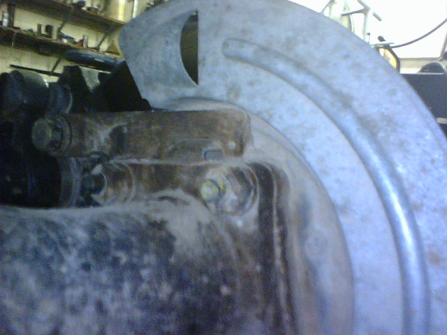

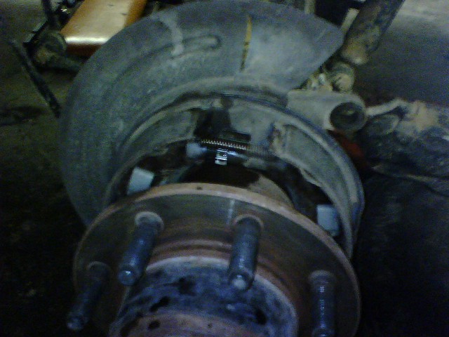

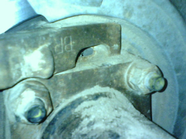

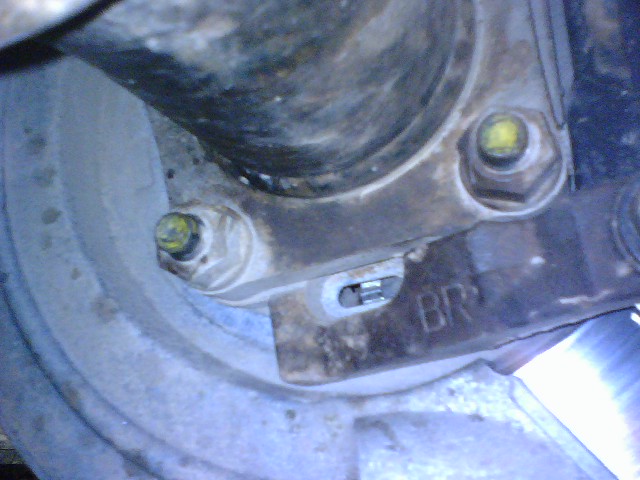

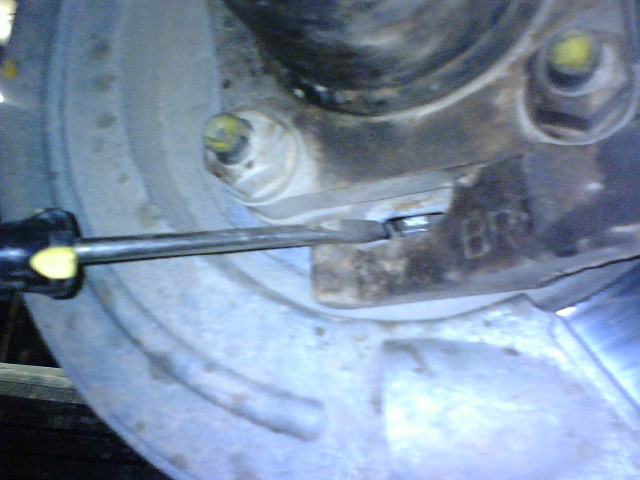

I could not see the adjuster locations at first, they were packed in with dirt.
I ended up taking off the wheels to check the shoes to make sure they were still okay. SLIM51015 thanks for the diagram. Made sure to clean up and lube the mechanisms while I was in there.
Driver side adjusters are on top, passenger side are on the bottom. If you are doing this for the first time, do the driver side first, they are harder. While adjusting the star wheels, you can feel them tighten up when the shoes come in contact with the hat drums. At that point I gave then two adjustments back, and it seemed to be just right. On my truck, the driver side adjusted up to get the shoes to move out to meet the drums, passenger side was the opposite.
The adjusters are located in the depressions by the letters BR. Inside of the depressions is the rubber dust plug that you must remove to get to the star wheel. Don't forget your flashlight!!!! Pind was right you will need it. GFB was right also, first time is a real Bummer after that it's a breeze.

Hey pind, it's not a pretty rear end, but at least my wife didn't mind me taking a close up of it!!!!
Hope these pics help.
