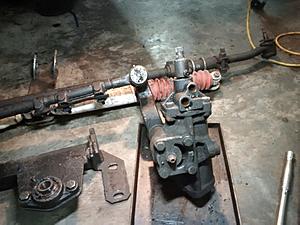

My buddy has the 2009+ style Borgeson box on his.... along with brace and HD steering. We re-installed it over Christmas.
Attached Thumbnails 2nd gen steering upgrade-img_20171228_160525-medium-.jpg

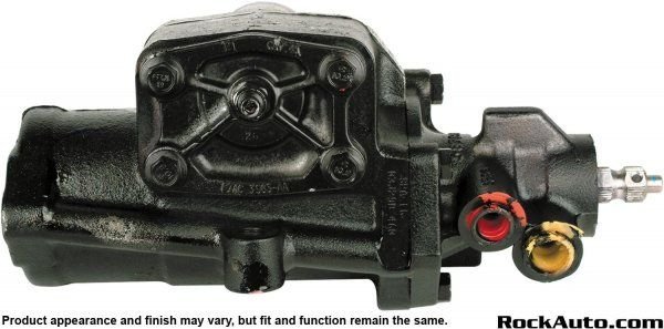

Reference pics for the Dodge boxes used for '94-'12
OE 94-02 style box:
OE 03-08 style box:
OE 09-12 style box:
