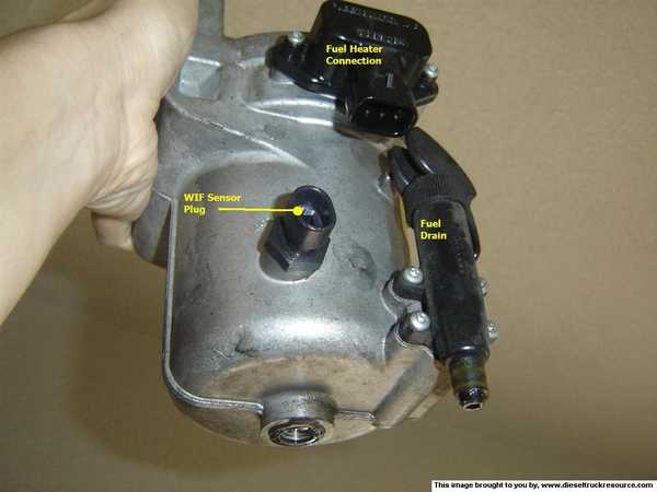

Anyone have the water drain on the fuel canister just start leaking fuel? I never use mine, and now it leaks a few drops everytime I park. Is that available as a part or do you need to replace the whole canister?

It looks removable. I bet you could replace the O rings in there.

I thought about just plugging it since I don't use it, but sounds like a plan. Let me know when you're available. I'm not in a huge hurry but would like stop it from leaking.

tried fixing mine 3 times new o-rings steel wool the boar no dam luck gave up and installed a 03 filter housing instead

CHANGE THE ORING . MAKE SURE IT Fluorosilicone TYPE OF ORING . THE FUEL WILL EAT AWAY REG ORING.

I had a leak on mine - believe it or not, I greased it up with some synthetic grease, put it back together and its been good ever since. Not a job you want to do when its -30
