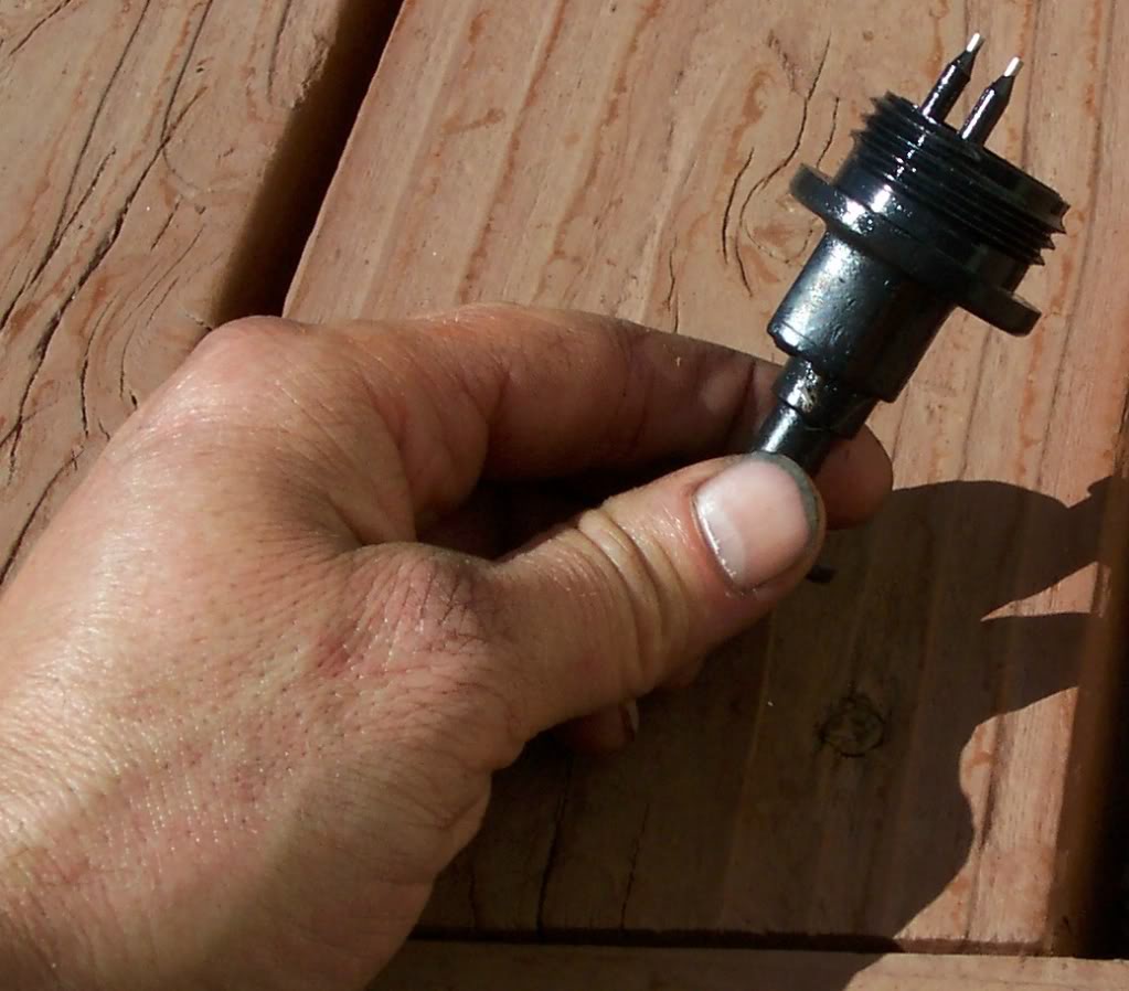

Fuel leak at the Water Drain Valve. This was so frustrating because the fuel filter should have never been placed where it is for reasons of difficult frequent access. At first the leak appeared to be at the valve itself so for $60 I bought a new one that only the dealer supplies.
I installed the new bleeder valve which had a new o-ring and I cranked the new part on tight. The leak continued. Finally after 6 or more removals and installs spending most of a day absorbing large quantities of Diesel fuel into my blood stream via my skin pores, enough to give a lab rat cancer then I finally figured out that this is a serious design problem.
The o-ring had to go. I was looking for a a thick flat washer. When you change this part you'll notice that the valve has a flat surface that meets up perfectly with the flat filter surface as if it were originally and brilliantly designed to hold a flat washer but Chrysler must have had budget cuts, fired the ingenious designer then brought in a lesser educated lower paid engineer to finish the job, now we all suffer the consequence. Could the designers see something so simple? Apparently not! But once I realized the problem was with the o-ring then I quickly found a fix.
The auto parts stores did not have what I was looking for. I went to Lowe's hardware store and found a flat rubber washer that works perfectly.
First remove the o-ring and throw it away. The flat rubber washer fits really tight over the shaft of the bleeder valve where the o-ring once was and is over sized on the outer edge which once screwed on tight creates a downward cone. This turned out to be perfect because now if it should ever leak you will know if the fuel is leaking from the filter contact or from the internal bleeder valve seals.
The scan code for the Lowe's rubber seal is 0-08236-76955-5 or part number is H#882648 It's labeled as "Rubber Washers 3/4 x 2-1/4 x 1/8"
I think this rubber seal was one or two dollars and could have fixed the leak before I spent $60 but now you know not to make the same mistake. Does Chrysler care? I seriously doubt it because they made $60 off of my prior ignorance & I suspect most would just take it into the dealer spending more money but hey, they need to make money just the same as you and me.

I had this problem one time on my 96...the filter was bad and would not allow the O-Ring to seal properly. It was a Wix filter and I have used many of them over the years with great success, but this one had a manufacturing flaw. You could see where the filter housing was only partially "punched" in the press that makes the O-ring indent so the o-ring would not seal. I took it back to the parts store and looked at several other filters they had in stock and none of them looked the same as the bad one.
I guess one just slipped by quality control and perhaps you got another one
That rubber seal you bought may or may not last very long unless the compound is made to resist diesel fuel. Diesel has a tendency to soften and rot certain types of rubber so keep an eye on your patch job.

I was concerned about the seal I used standing up to the fuel so I will buy another seal and soak it in a jar of Diesel fuel to see what it does, last thing I need is to have that blow out or clog the filter while pulling a load. I was hoping someone else could pitch in on a specific flat seal to purchase that will hold up to the fuel. The thick flat (fuel resistant) seal is the way to go as it would seal even the defective fuel filter canisters.
