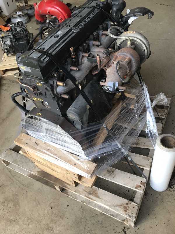

The yard in CO has the engine I bought on a pallet, so I will wait to see how this one looks like. I have not been further NE than Boston, other than flying into Maine one time, so a road trip would be nice but I would ideally need 2 weeks to do it justice... Maybe next time..
