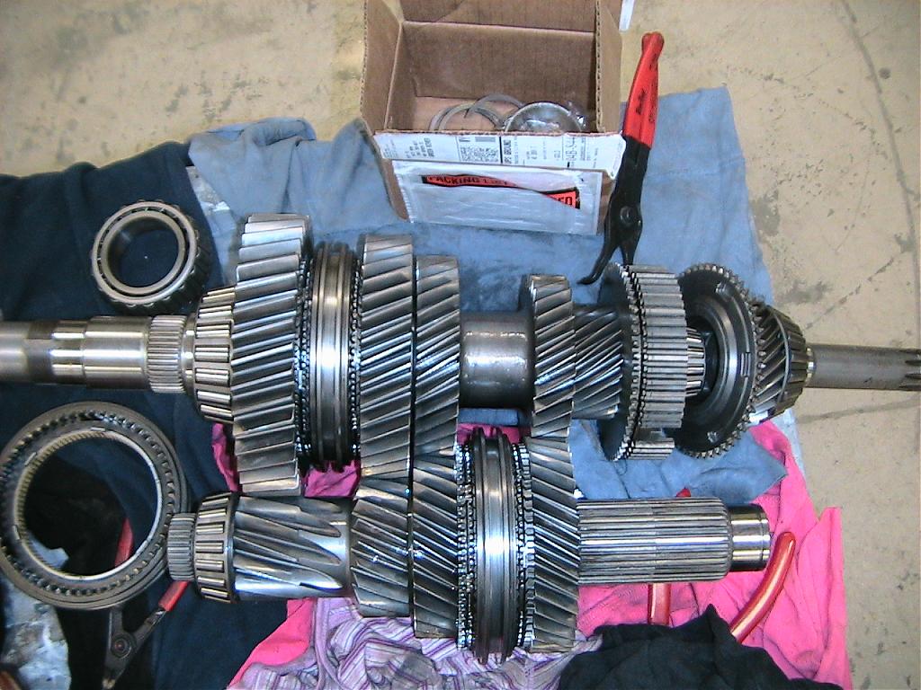

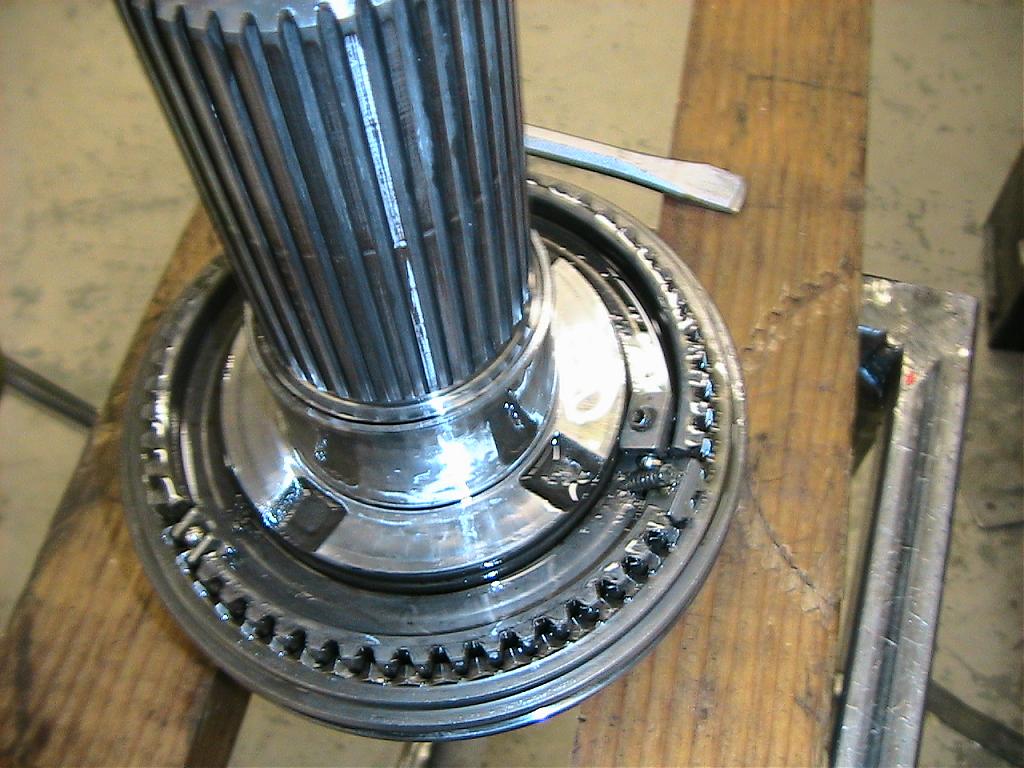

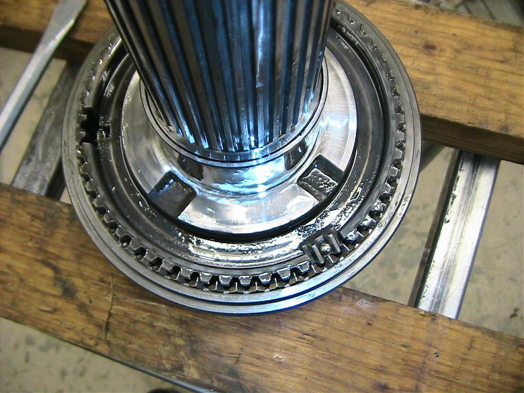

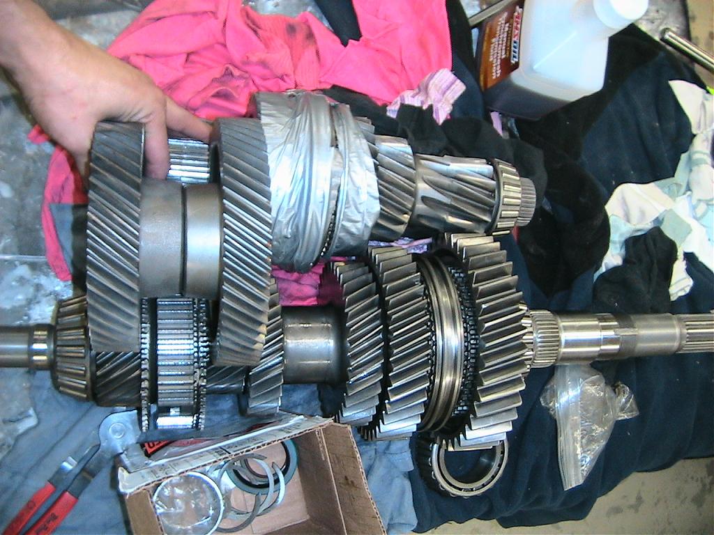

- Here you can see the springs, dogs, and ball bearing inserts that go under the shift fork. I have easily spent 4 hours trying to install 6 of them. (I am getting alot better at it though!)
- Then you can see the 3 and 4th gears and synchro assembly lookin all pretty there.
- I then placed the countershaft next to the main shaft. (the 5th and 5th countershaft gears are missing)
- finally, you can see my nice duct tape job holding the 3 and 4 synchro together as I hold the 5th and 6th countershaft gears in place and you can see it all together minus the reverse assembly which goes in the the tail shaft.
I have the 6th C.S. gear pressed on now and am going to heat the 5th C.S. gear and try to press it on maybe today. It's been a long time but I can finally see the light at the end of the tunnel!
