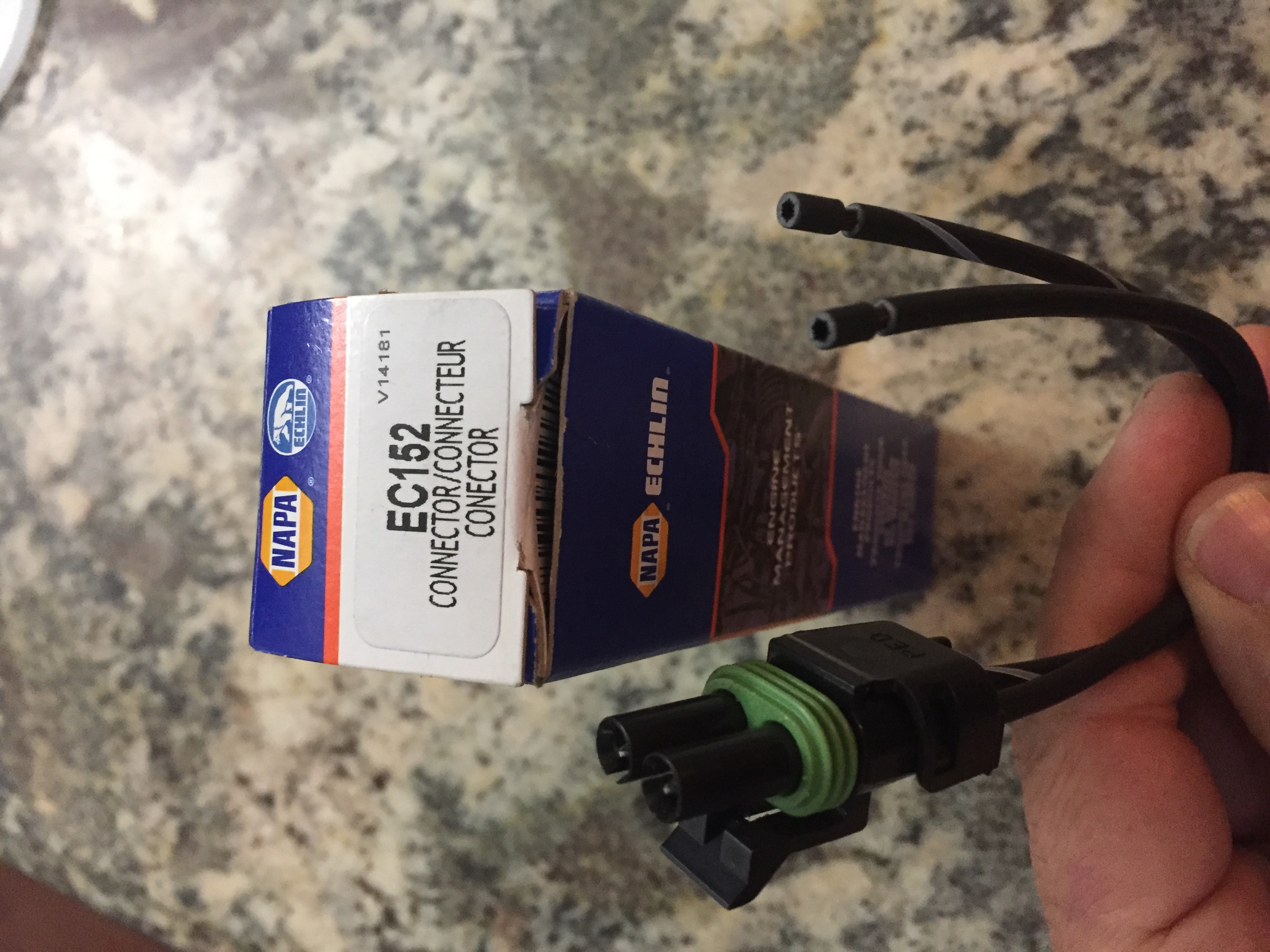

Napa was however able to provide a P/N for the pigtail with the newer style connector,
which is Napa P/N EC152 and costs $24. (picture of this shown below)

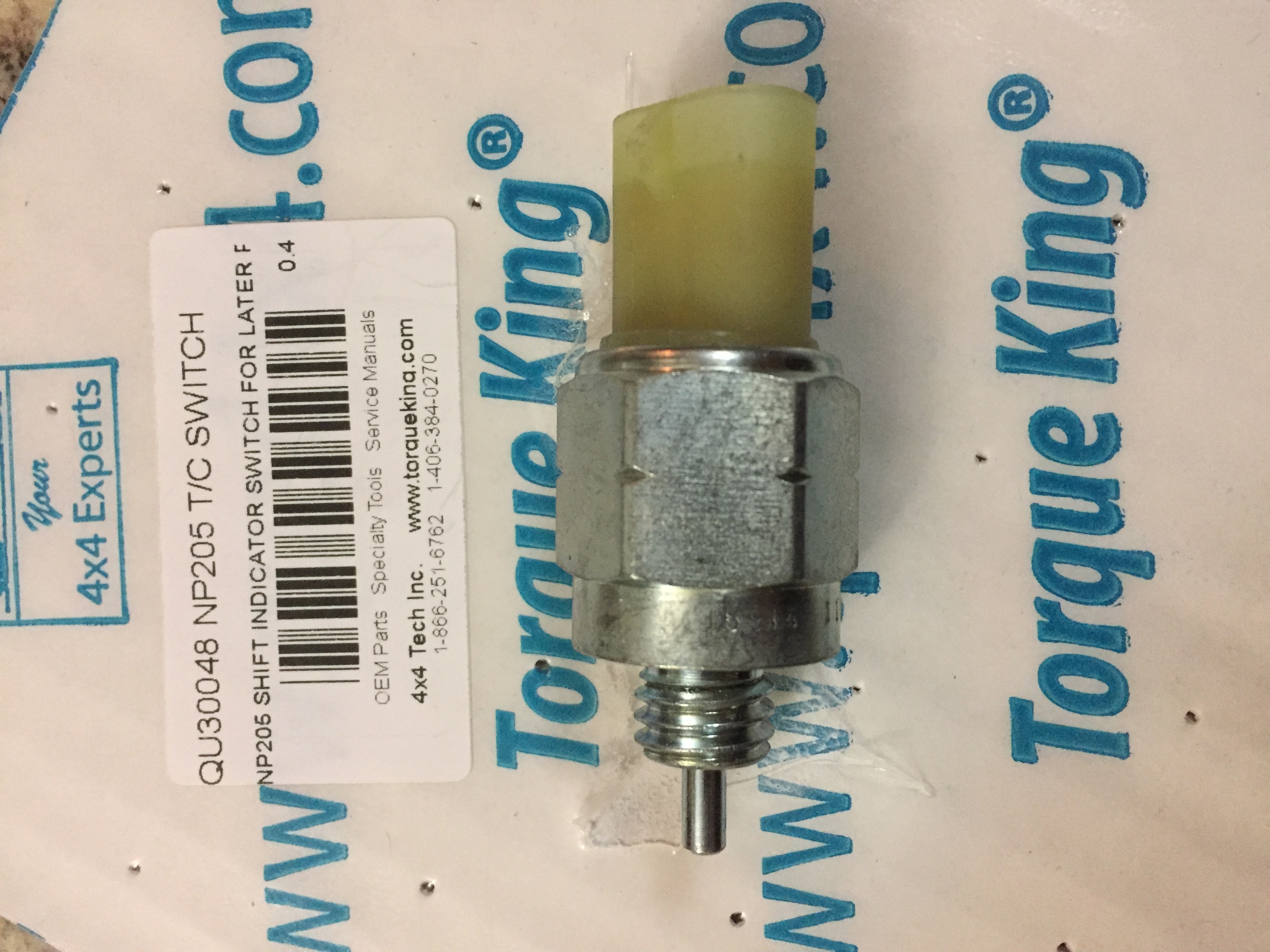

Searching further online, I did find where 'Torque King 4x4' has a switch with the newer style connector and coarse thread. Their P/N is QU30048 (picture of this shown below), and sells for $98 plus S&H (a bit costly for what should be a $15 - $20 part in my opinion). The also give the impression their supply of this part is very limited.
QU30048 NP205 T/C SWITCH in NP205 Specific Parts

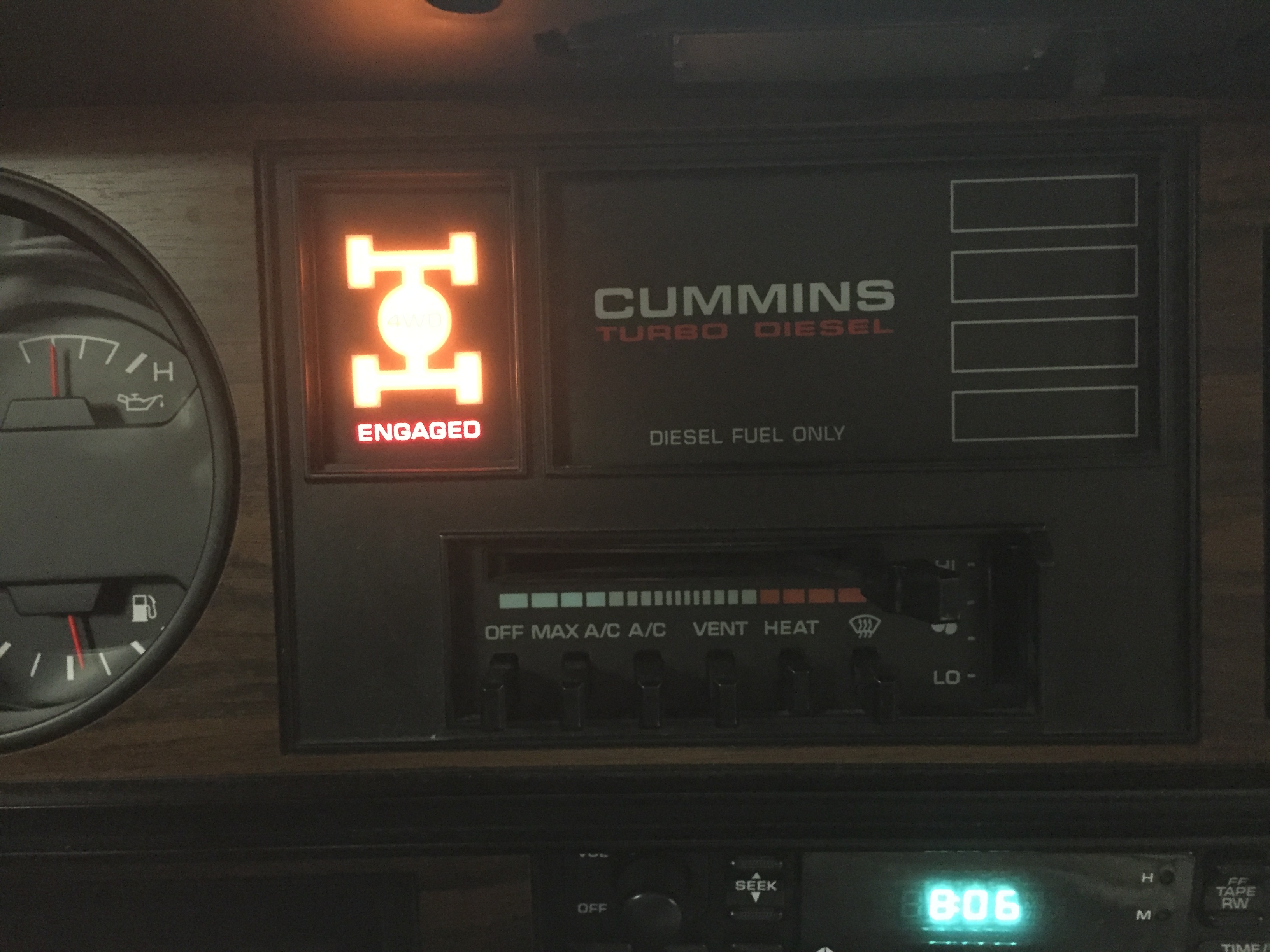

So the parts to get the 4x4 indicator working are still out there as of Dec 2016, but will cost about $130, which for most is not worth it. I'll went ahead and spent the $$'s because 1) I hate when stuff don't work as it should, 2) I wanted to see what a working 4x4 indicator light actually looked like, and to be honest.. its really large and bright ... almost annoying if you are driving at night.. but hey, its working

The pigtail you found at Napa EC152, looks like in your picture a standard weatherpack connector? If it is just a standard weatherpack connector you can buy the parts to build the same thing for somewhere around $5.
