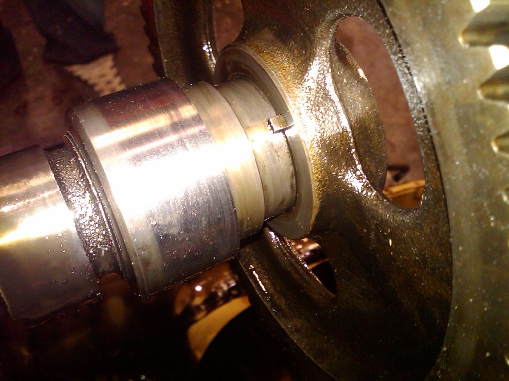

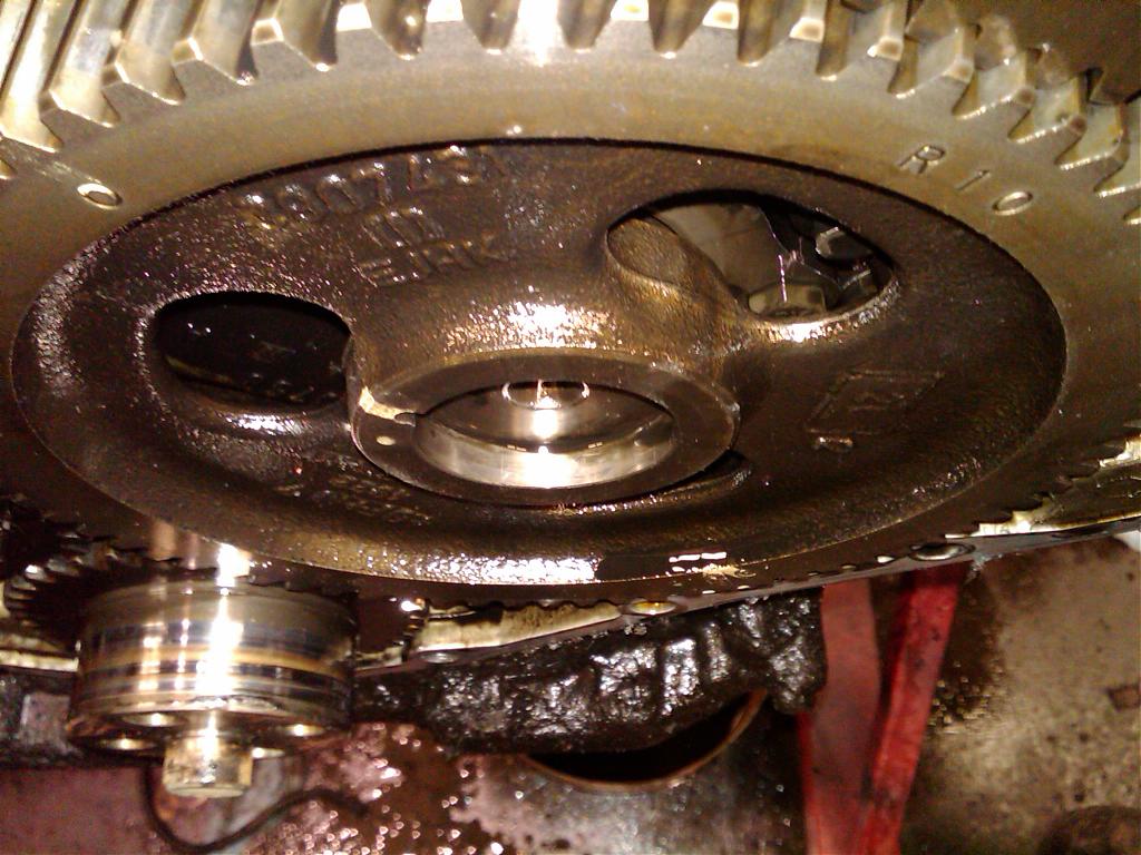

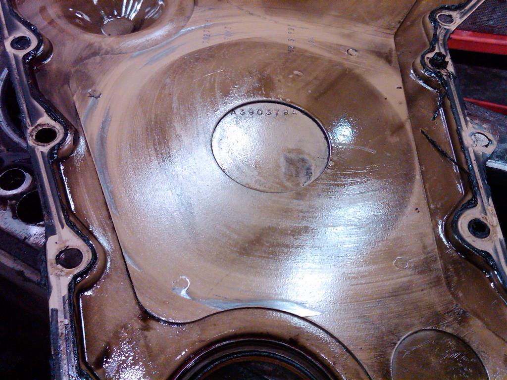

Well maybe these pictures will prove that at some point I did make some decent HP. Now I know why I lost 163hp on #2. The cam moved so much it knocked the back plug out which is where my oil leak has been coming from. I guess this is another first for the first gen crowd because this usually happens to the p-pump guys. My new cam has been drilled and tapped for a retainer.
For those of you that are putting up some good numbers you might just want to check your cam. I was very close to loosing my motor. The cam gear was out .440 and a couple of the retainer bolts were loose.

Looks like your motor almost became a horizontal boring mill. Glad you guys caught it before it wiped out everything.
