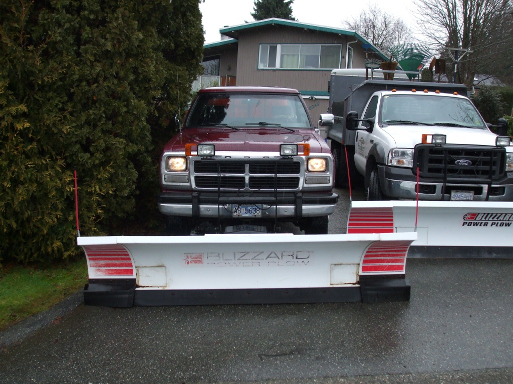

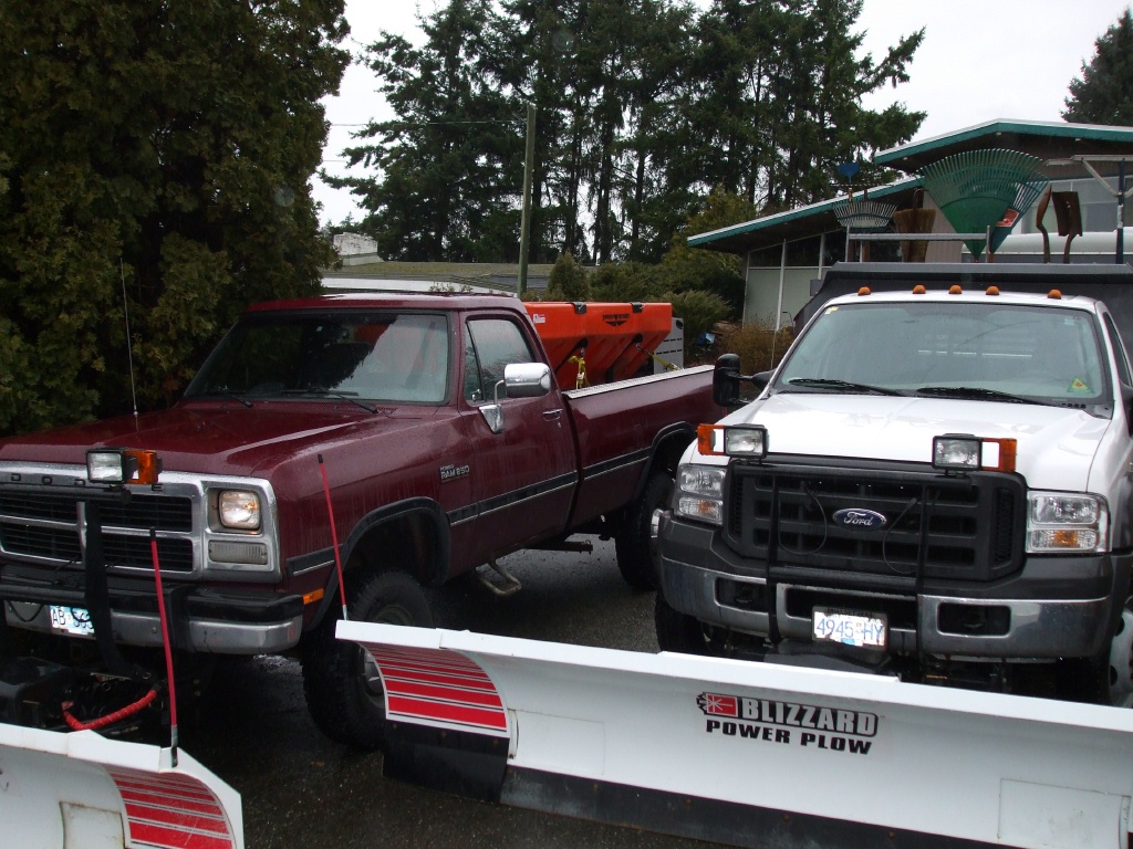

I added two extra leaves and rearched the front springs to carry the weight 1000 + pounds of the blizzard. It raised the front of the truck 3 inches initially but should settle around 2" higher. When I lift the plow the truck drops 1.5 inches.
