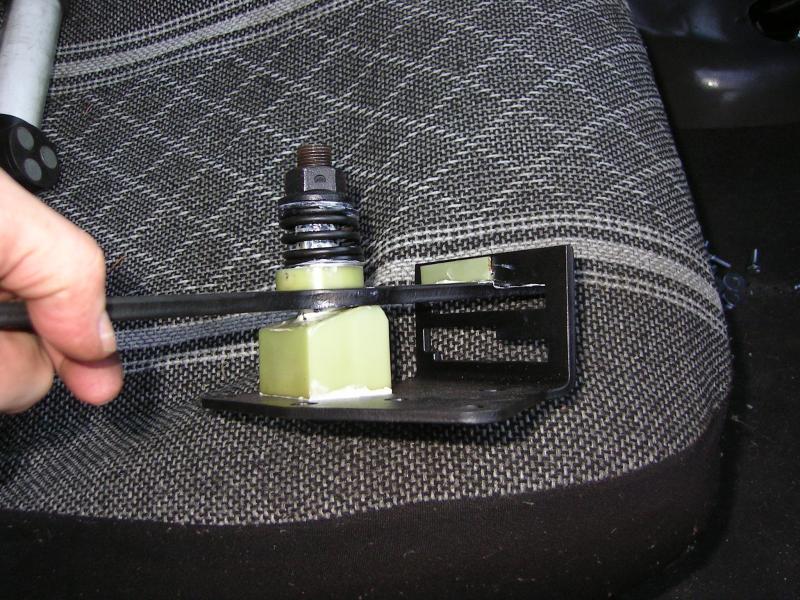

Old Feb 8, 2014 | 08:08 PM
I have Never seen a different shifter so yes you are Right Brian . If you have a Picture of a different style Please Post it .
Gated style shifter...from a Cummins/A518 truck...
And after I modified the auto unit to look like gated shifter from a getrag.....
Old Feb 8, 2014 | 11:00 PM
simplysmn's Avatar
Posts: 2,273
From: Apple Valley Ca.
Hummmmm ok makes sense I have a getrag shifter in my auto .
Old Feb 9, 2014 | 10:43 AM
cougar's Avatar
Joined: Apr 2009
Posts: 3,317
Likes: 485
From: alaska
Looks like mine, except mine now has an extra hole in it.
