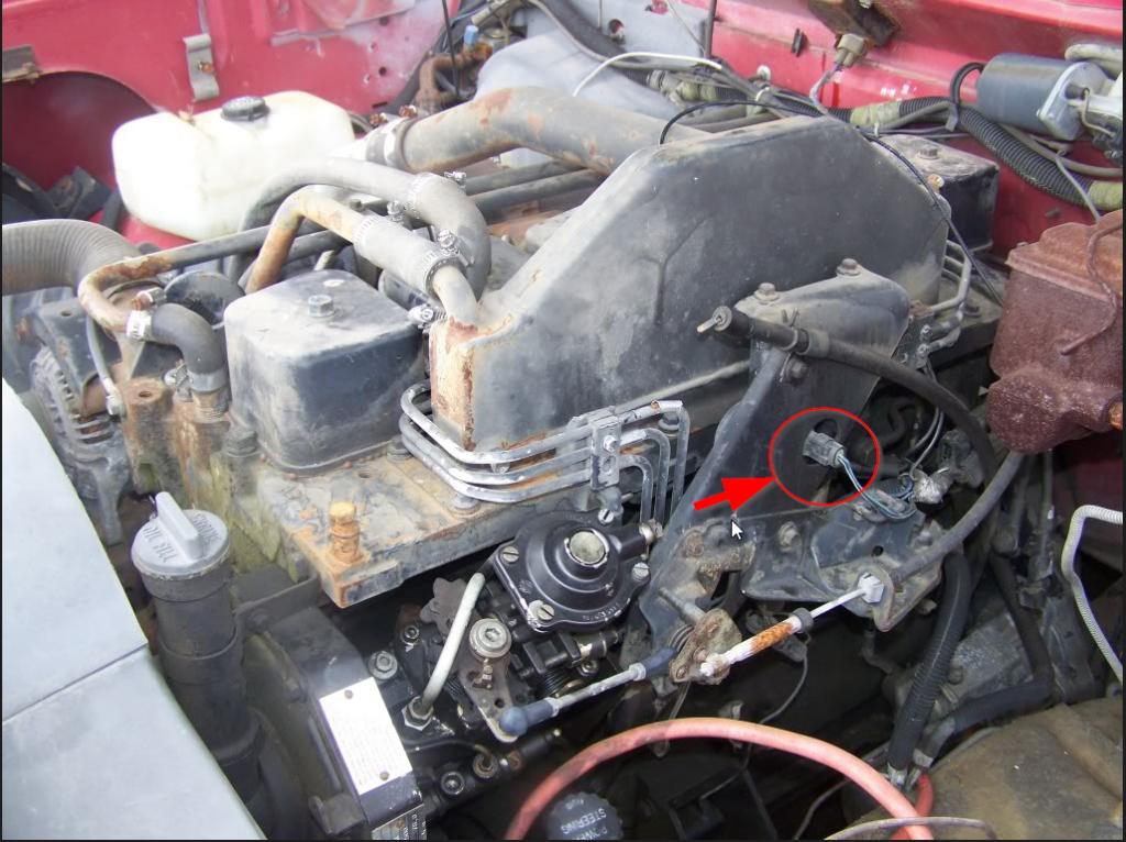

Trying to track down what sensors do what on my non-ic cummins. It was transplanted into a 1994 Chevy K2500 and some things weren't hooked up if they were not required to run. I think this sensor / switch either turns the KSB off or is some sort of feedback for the intake grid heater. I could be totally wrong though so I figured I would ask here.

The non-intercooled KSB is a heat motor that advances when cold and retards when hot. It gets 12 v when the FSS gets it, and heats up in a few minutes. My guess is the sensor is manifold temp input to the PCM to control the grid heaters.

That is there on the non-intercooled trucks, too. No idea what it does.
I don't think that first truck has a grid heater. That aftercooler would be slick for the non-IC trucks, though.

I would agree with Mr.Martin that the sensor your asking about is the air intake temperature sensor. But the Non-IC trucks don't have a PCM....just a grid heater control box.
