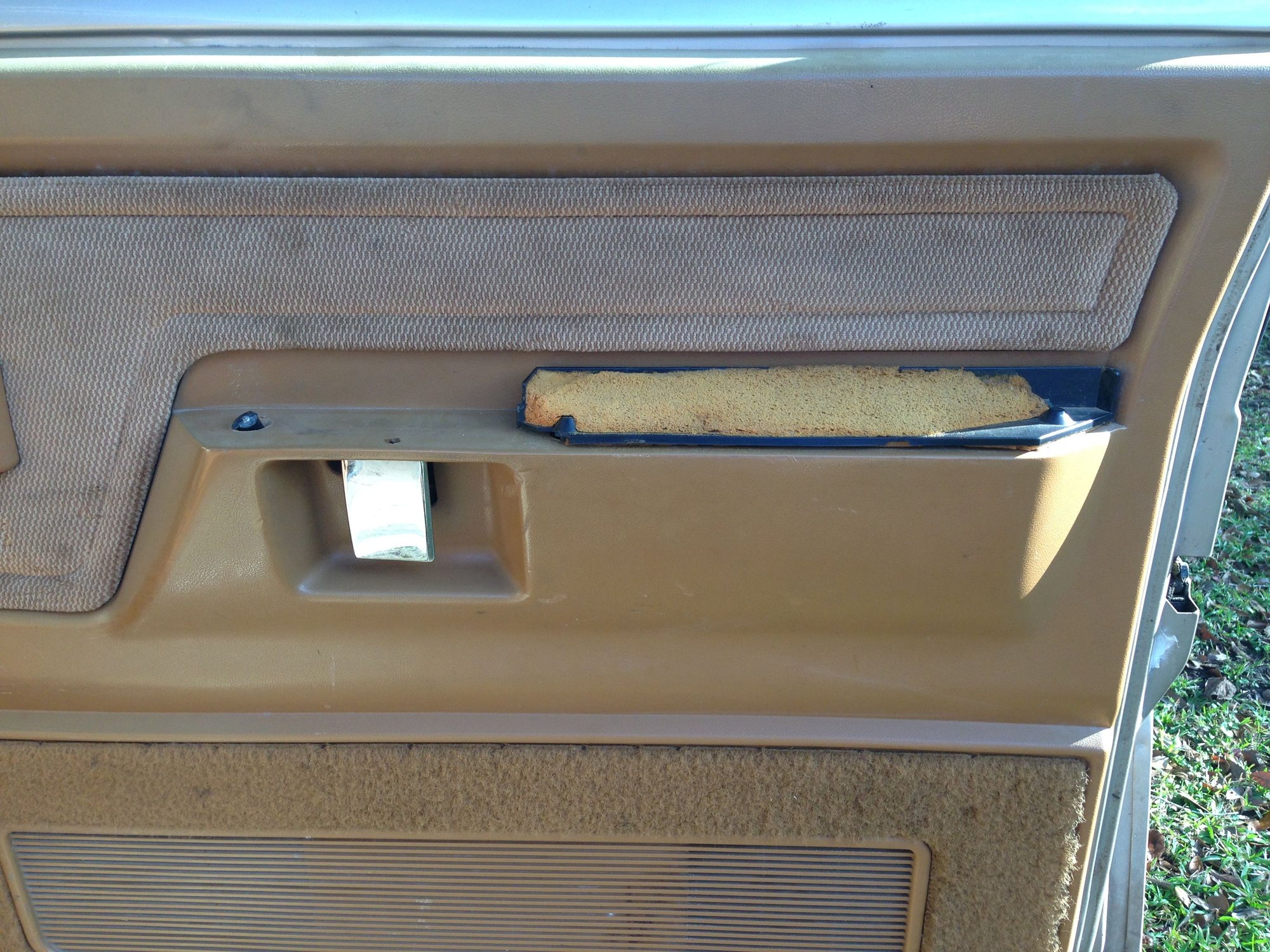

looking around at all the armrests at the local upullits they all have divots in them. Wonder if harder foam would take care of that?

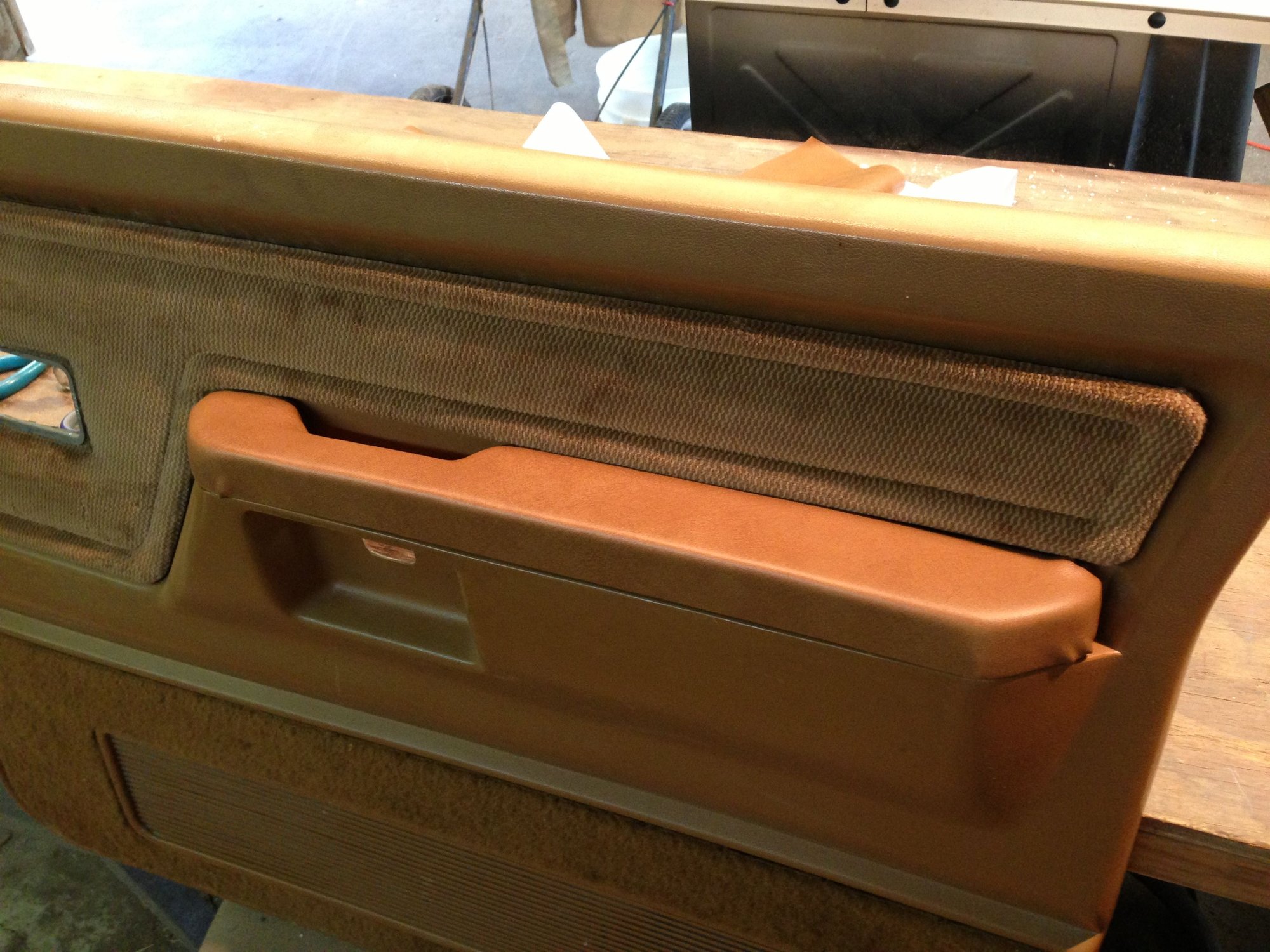

I eventaully made mine with rigid foam and covered with matching vinyl. You can cut the foam with a sbre saw or band saw.

Nice job!!! An electric carving knife works too.

Where did you get the foam
Local upholstery shop. The lighter color is more rigid than the darker so you can screw into it. Bought the vinyl covering to match at the upholstery shop also.
