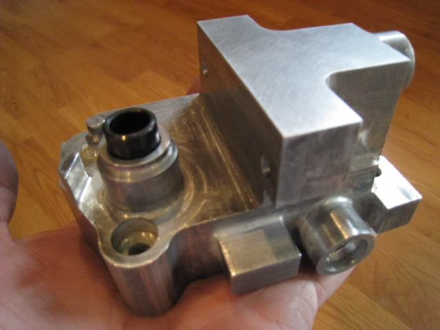

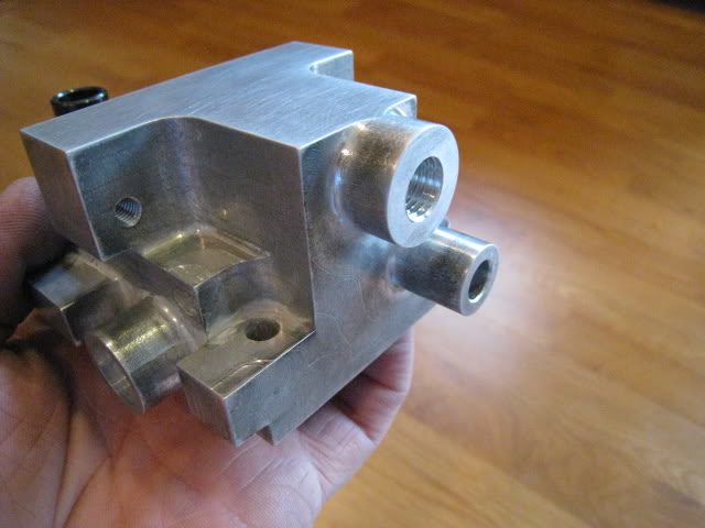

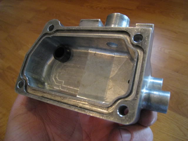

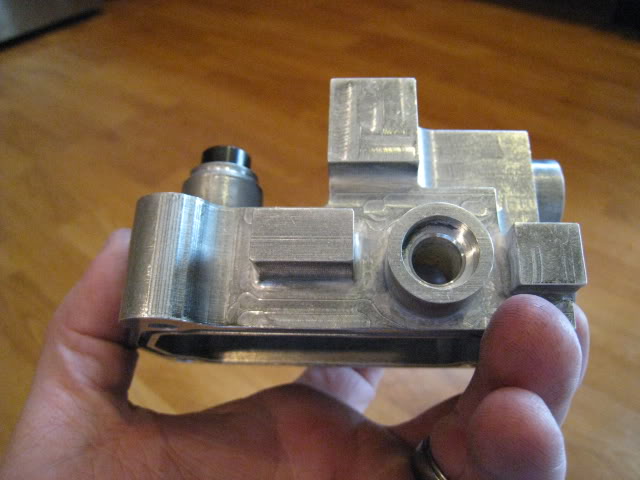

I stripped the threads on the return line and 2 out of the 4 bolts to the afc cover were toast. I dug around for a spare top with no luck so I turned to the CNC. I built a custom top out 7150 2.5" thick plate. It took about 6 hours to model in GibbsCam and about 3 hours to machine. I thought yall might get a kick out of this...........
Top view with new throttle shaft bushing pressed in

Bottom side with gasket groove

Side view of manual shut-down lever

Fuel return and fuel rate
