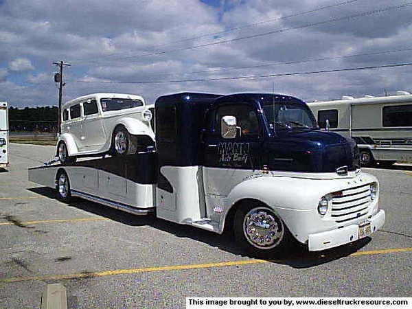

I do have 19.5 wheels on my rig. I thought the only reason it would not work was because of caliper to wheel clearance and felt with the 19.5 wheels there would not be a problem. I also have another question for you guys. This truck actually is a car hauler built on a 93 Dodge 1 ton 2wd chassis. When I load a car onto the bed, my total weight is 13,600 lbs. Since I am trying to stop that much weight, I thought about fabricating a special bracket that would let me mount dual disc calipers(2 per wheel) on each side. I know this would greatly increase stopping power, but would it generate so much more heat on the rotors that it would warp them???You may go to my page to view the truck so you can fully understand why I am looking for so much more braking ability. I built the entire truck, and fabricated the bed and the sleeper myself, so I can make my brackets myself if it can be done.

Beautyful job on your truck. You should post a thread on how you built it.
