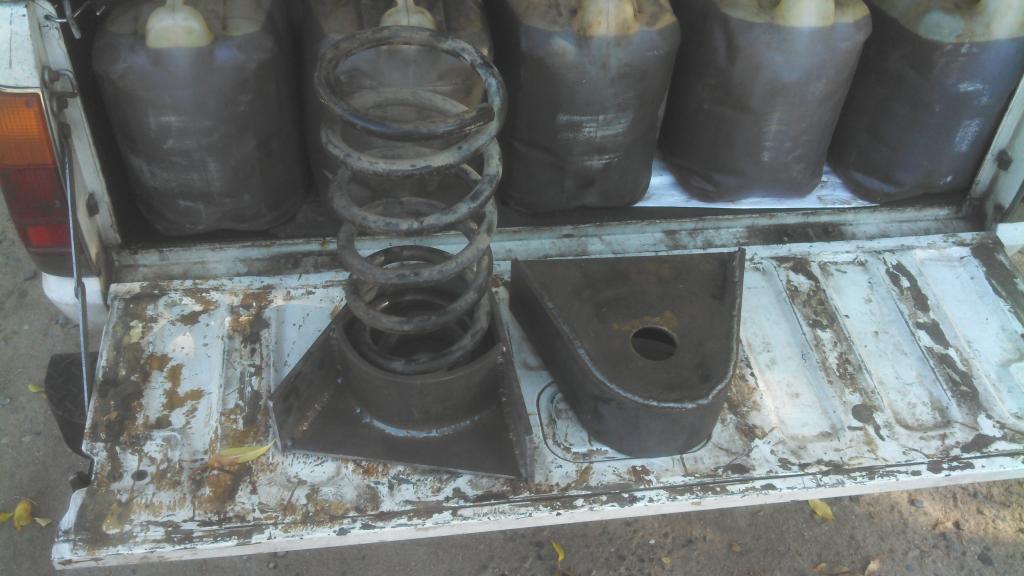

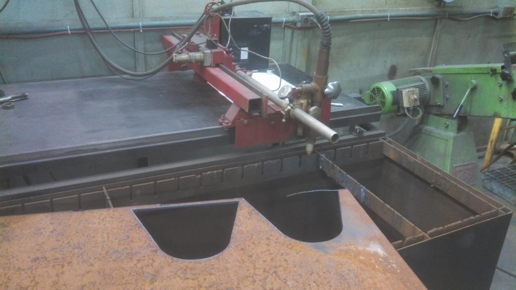

A few pics of building the spring pockets

gotcha, missed the D250 in the first post. Sounds like a solid plan, can't wait to see it come together.
Those spring pockets look beefy
