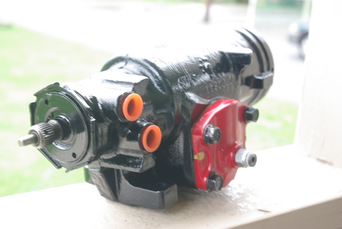

Got tired of my leaky junk yard gear box.
Went to Seattle and got this.
Attached Thumbnails Reverse Rotion Steering Box-redhead-001.jpg   Reverse Rotion Steering Box-redhead-002.jpg   Reverse Rotion Steering Box-redhead-003.jpg   Reverse Rotion Steering Box-redhead-005.jpg   Reverse Rotion Steering Box-redhead-006.jpg

Nice. In stock 3/4 input configuration as well. Any differences in steering feel?
Looks good!!!!
Did Harvey rebuild your box, or did he have an existing core in stock to work with?
--Eric
Old Mar 15, 2012 | 10:49 AM
  #119
bobva's Avatar
Posts: 840
From: granite falls washington
Originally Posted by enafzige
Looks good!!!!
--Eric
I don't know who rebuilt it.
Court ( I believe that is his name ) helped me out on this sale.
The GB above is a off the shelf stock unit.
My old one is still there.
