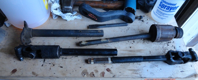

Hey Papecat. That's the Pitman arm you sent me. Amazing what rust converter can do for a rusty old piece...

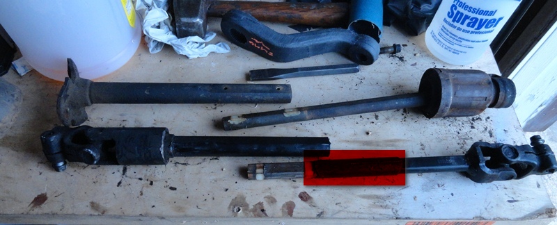

What is that highlighted in red?

Mine has that thing in red as well. Actually all of the XJ shafts I pulled / looked at in the yard today had that "sleeve"
Not sure if it will need to be removed or not to make it fit in the first gen.

Strange mine has what looks like a mini shock absorber dust boot.
Im very sure it will need to be removed. INSTALL only reason.
All of the shafts I found had the plastic sleeve that you're referencing. I assume it's for something that is utilized during a crash ?????
All the shafts with a rubber boot that resembled a shifter boot or shock boot were all in later year Jeeps.
Maybe it's a regional thing..... Don't know.

Yeah so the XJ shaft don't fit. It is a 3/4 like the newer boxes. The old Reverse boxes have the bigger 13/16" input. I have a universal joint on order right now 13/16" spline on one side and 3/4DD on the other (to be fastened to the Jeep shaft after I cut off the small ujoint. I'll let you know how it goes. I should've just bought a borgenson first off weeks ago and been done with it. I have spent 2 days driving around to the yards picking and pulling shafts and none of them fit. So now I have a 100 dollar ujoint that I *hope* fits and have to cobble together a custom solution.
Problem is only older trucks have the 13/16" input shaft and all of those I've seen have a rag joint at the box... No U Joint. So custom is the only way - cobbled or borgeson your choice. Or you can replace the whole early dodge steering column.
