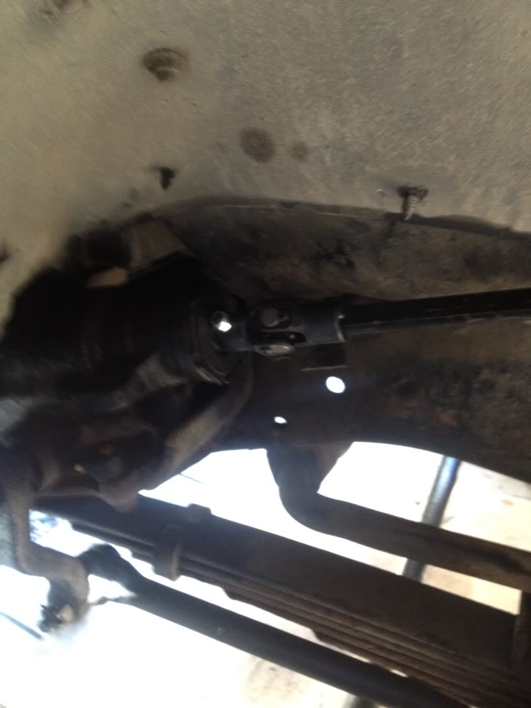

Hello T:
Old Mar 4, 2012 | 03:33 PM
  #101
Originally Posted by PapeCAT
Hello T:
Hey Papecat.
Thanks for the pic. Man, it's bright there. Cell phone shot, I assume.
It's been overcast for most of the winter here, and not any snow to speak of. Nice weather coming up thursday... 60*f and sunny. Don't want the snow now.
Now the eternal question.
How much different does it feel ? Turning radius affected at all ? Any notable change ?
I bought the draglinks from rockatuto TRW DS869, but they differ just slightly from the ones that everyone else is using... as it's perfectly straight, with no bend in the one end. Is that what you used, or did you get the bendy bus one ? Got 2 for the price of one, so I own them now (closeout) Still the 4500 lob unit, though.
I assume you used the reinforcement bracket as well.

Hello again T
Steering feels nice n tight
Not as tight as the grail 93 though.
I bought a drag link from napa it has a curve. I ran straight links on the crew and ram charger with d60 with no issues even with 37" tires. The way it is curved is to provide a bit more tire clearance at full right turn.
Two and a half turns lock to lock. No difference in radius still hits steerin stops no prob.
Didn't have a steering brace an turns out the previous owner drilled the plate up to 9/16" bolts so would've been a pain to drill the bracket too. It is plenty strong anyway. The bracket was for the new style anyway.
Thank lets know of you have any more questions.

Why ? Which box did you purchase ? Any drifting on the highway ?
That's the same setup the guys from NY were using on their snow plow trucks, and I was concerned with how it handled on a highway being that "touchy".
