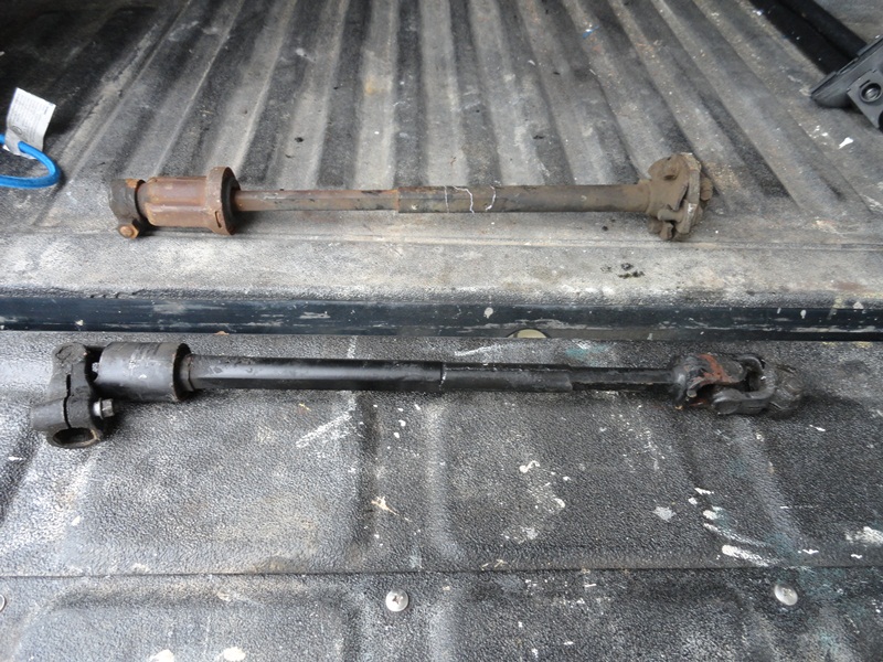

Bob,
Enjoying the snow you said you never get ???? Liar liar, pants on fire !
What is the top steering shaft you have in your pic ? The bottom is the boregson, right ?
I still don't have my gear back, but I've been on the lookout for the shaft as mine is all boogered up by a previous welder.
T.
Old Jan 27, 2012 | 01:19 PM
  #63
bobva's Avatar
Posts: 840
From: granite falls washington
TOP chevy 1/2 ton 75-86
Bottom XJ cherokee 88-92

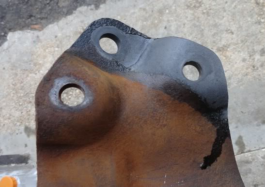

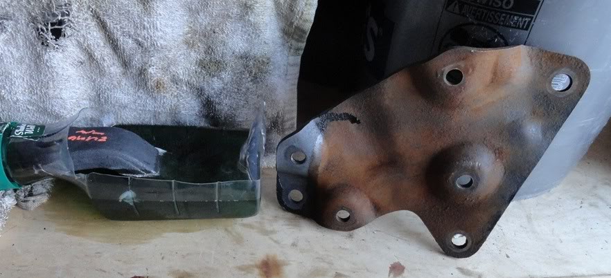

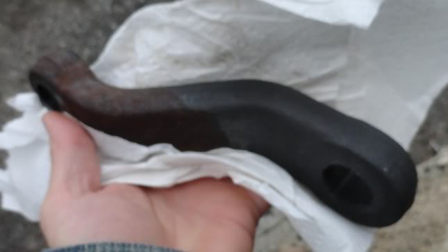

Here are the pix, I promised you. Sorry, I'm still not back to feeling better, otherwise I would have put them up sooner. I let the parts sit in overnight, and by morning the rust is completely gone and neutralized. All that's left is to throw a coat of primer and paint on it, and mount it up..
Thanks to Papecat for the arm. Really cool you did that for me..
. You gave me an arm, and I threw you a leg.... or at least a bunch of tunes to put on your IPOD....
Pitman arm 1/2 way through the rust converting process
I just used an old orange juice container that I cut open to sit the arm into. overnight
Here's the first test of the extra PS Gear plate I picked up recently.
This is the stuff I use to convert rust. It's mainly phosphoric acid, but I'm sure there's a few other things in it I wouldn't want to know about.
